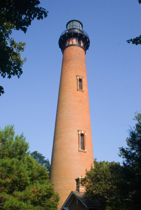

Hi Guys,

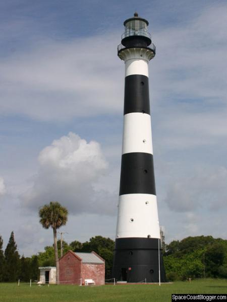

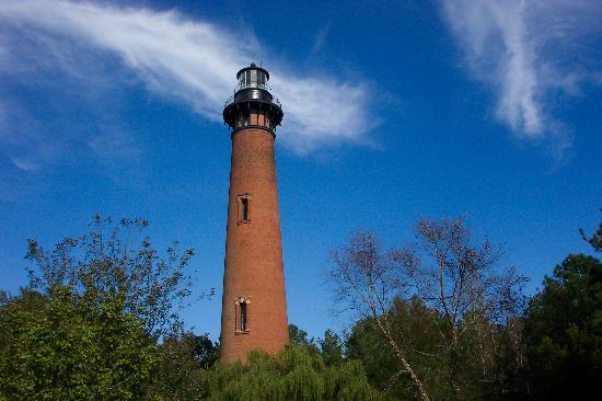

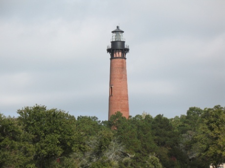

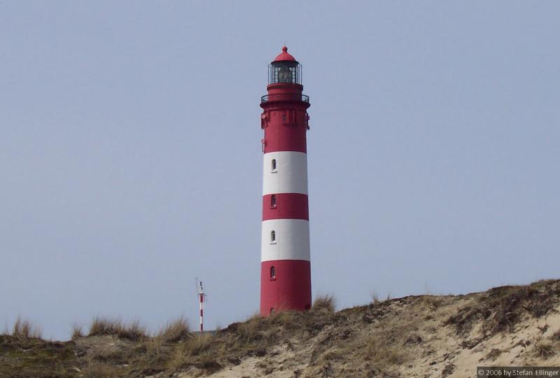

I want to make a lighthouse pen for my mother for xmas. My plan is to use the Panache kit as a base, modify the top to look like the top of a lighthouse.
Want I am looking for input wise is how to give the pen the look of bricks?
I know I could just do the black & white, but bricks would be sooo much cooler. :) To look correct the pattern would have to be very small.
Pics below...

Pics
Don Gaiser
May 16, 2009
72
Port Angeles WA.
Very nice stuff, and the lighthouse pen is top notch... and if I cant find a satisfactory way to do bricks, that is the route I will take. Thanks for your input! :)

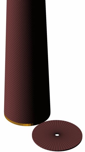

Actually I was thinking I want it to look like this... picture the tower as the bottom half of the Panache, which means no way can I do it veneer style :(
It took almost 45 mins to make this in Lightwave, it would prolly take 45 years to do veneer segmentation like this in real life.

juteck
Dec 10, 2008
861
Charlotte, NC
For "brickwork" that fine, you might want to consider talking to someone with a laser engraver to burn the mortar lines in, then fill them with color if needed after that. Bloodwood would be a good choice for the red brick, but you'd want to talk to the laser gurus on that. A plain piece of wood without much figure would be your best choice, so the grain doesn't affect the illusion from the laser lines.
Alternatively, you could always get a decent pyrography burner and fine skew tip pen and burn the lines in yourself -- it might not take quite as long as segmenting the veneer.
