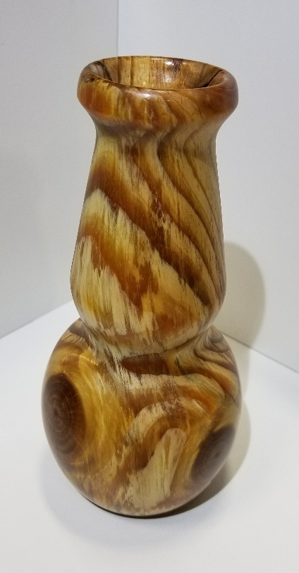

Anyone ever work with it? I gotta say, it's not fun. :frown:

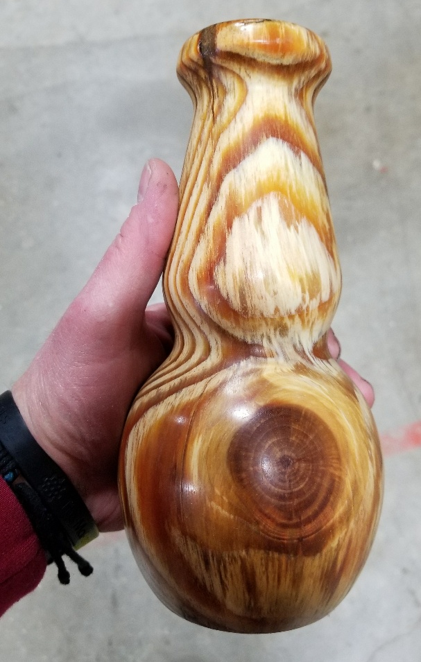

The chips are sticky, the pine smell is strong, but it cuts great. Sanding however is expensive because I went through several sheets of paper. The pine sap clogs the paper faster than anything - Even with the Lathe off!
This is with no polish, I simply turned the lathe up high and let the heat from the rag draw out the sap, which became a natural polish. It has cool grain patterns in the areas that are still wood, but this is at least 60% sap.

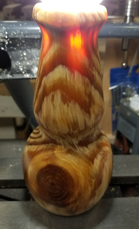

I really like how the light will shine through the thinner part, I'm not good enough yet to hollow out the bottom, so I may alter it from here. Maybe turn it into a small bowl so I can get that effect over the entire piece.
I bagged all the shavings too - I'll use them for fire starter when I go camping in the spring!

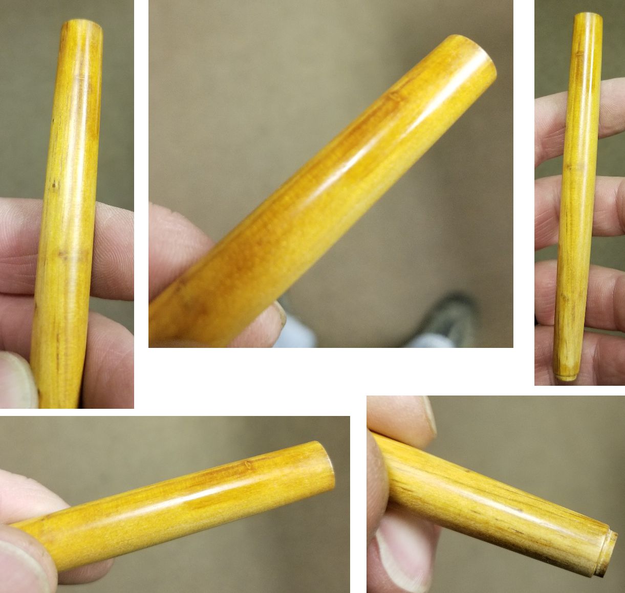

This is a pencil blank I turned a while back, not realizing it was this same type of wood. After I turned it, I put it in the toaster oven to draw the sap out, then back on the lathe to polish it. as it cools it gets very hard and shinny.
