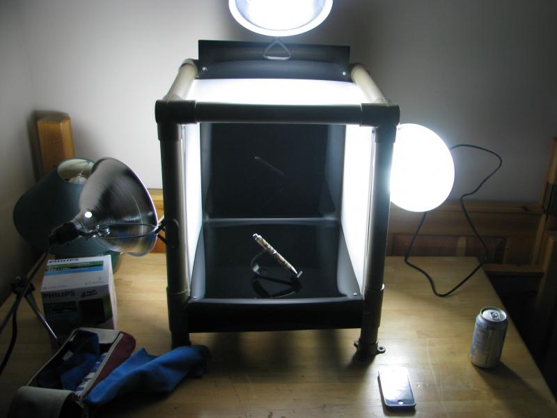

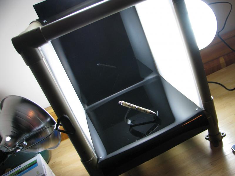

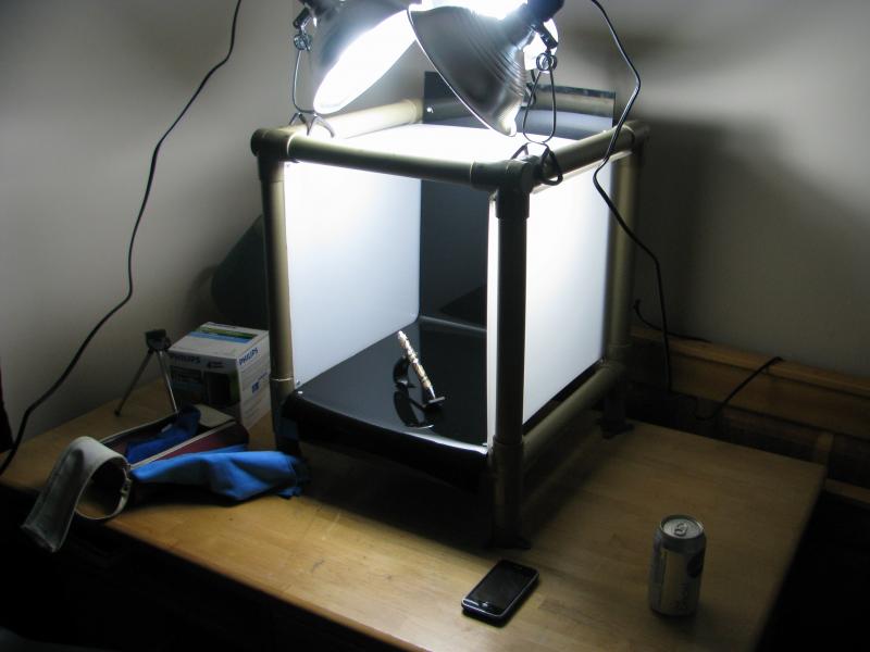

I finally have it done now, just working on settings on the camera and getting use to the new set up.
Alot of variables go along with taking photos, never realized it before.
Well here are some photos of the tent I made. Seems to work pretty good I do see a difference in quality now with the photos. I did post a few in the Show Off Your Pen section. They are untouched and I still have a long way to go.

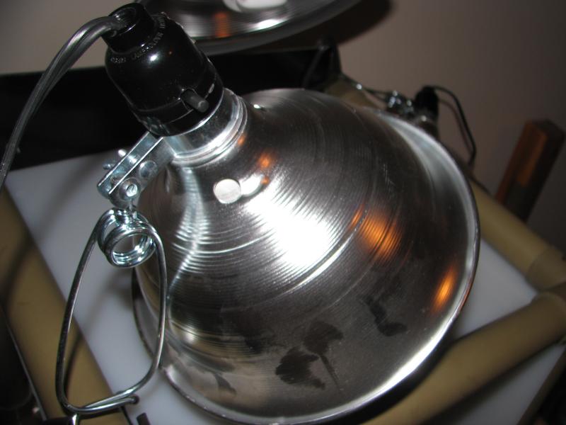

Everything was from stuff lying around the house or scrap leftovers. The PVC was actually from outdoor dog bed/tents. But my Cooper destroyed one so I just recycled what I could. The lexan Sheets I have had for about 2 years and never used it. Came from a friend. I did buy the lighting though. $10 a fixture and 15 for a 4 pack of 23w daylight bulbs (Home Depot). So I did spend $50 on lighting.

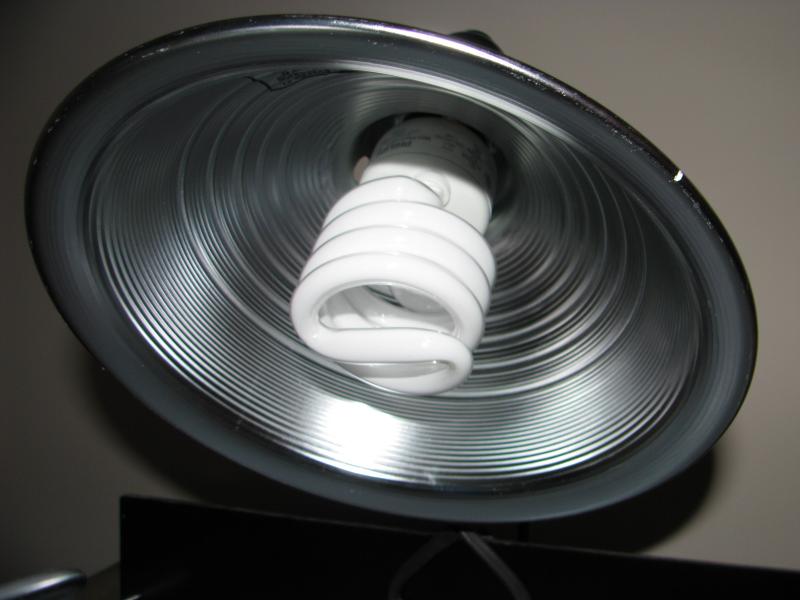

oxx44 could you post what the proper name for the light fixtures or where i can find them?
Also on the lights are the the energy saver fluorescent or incandescent bulbs?
I was at lowes they couldn't help me with the fixtures and ask about the bulbs the guy said they are over there on the first aisle.
As for the bulbs I still have the box so I took a pic for you.
For the fixture, you are looking for something like this http://www.lowes.com/ProductDisplay?...llow&cId=PDIO1
You are absolutely correct. These are the exact fixtures I got from HD.
Hope this helps keep us posted.

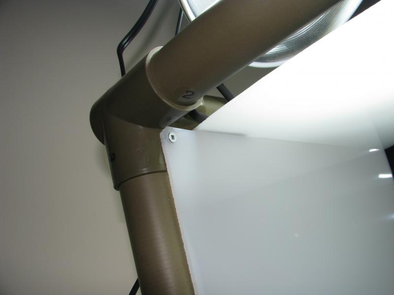

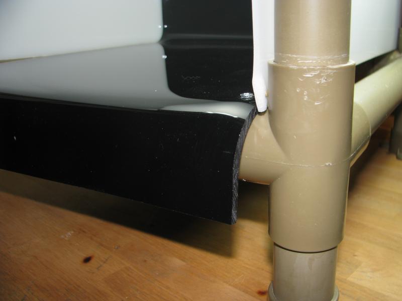

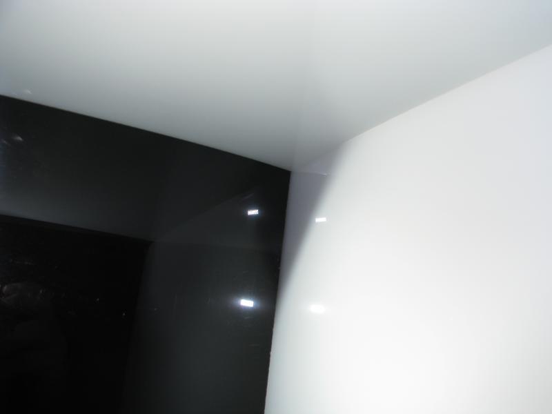

How thick was the lexan was you using?
Any closer pictures of the assembly?

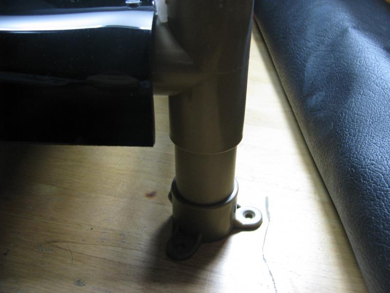

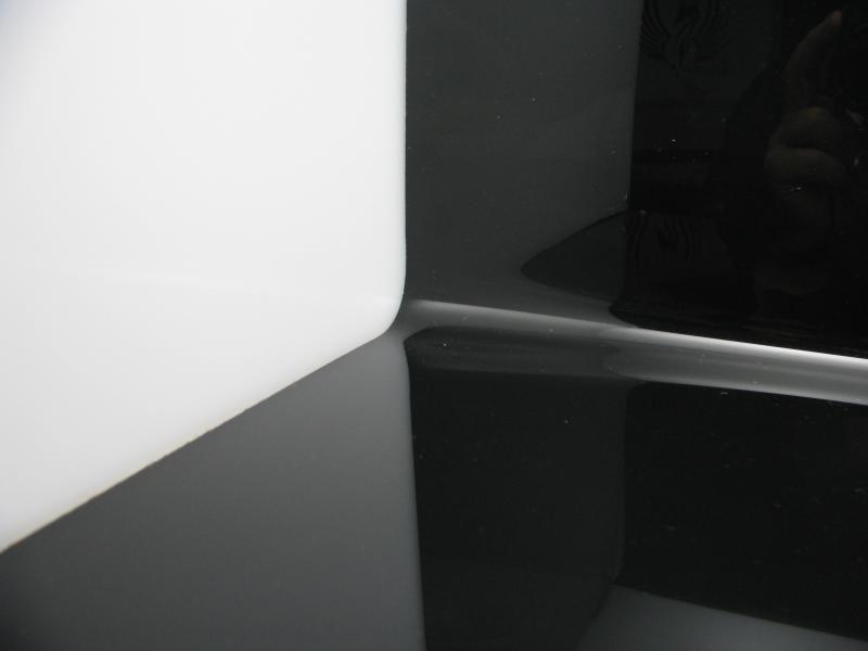

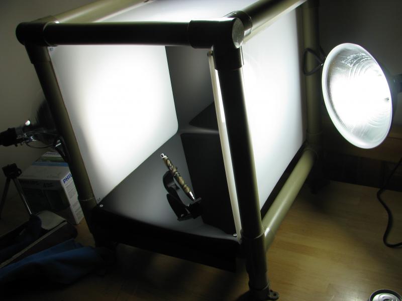

I am using 1/8 inch Lexan all around.

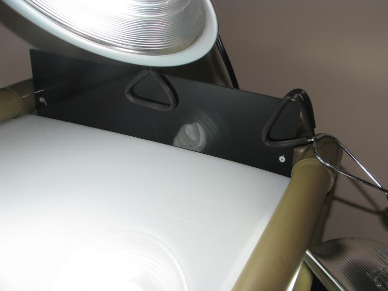

I hope these pics will help you more of what I did.
The top piece is NOT screwed in it is a tight fit between the PVC and the side lexan pieces that are screwed in. I left A high lip on the black lexan that is heated and bent in the middle and the front. The High lip is just for mounting the squeeze claps from the lights. The PVC works for the lights as-well, so Light placement possibilities are endless. I only curved the front lip cause I didn't want a straight edge there for me to hit while taking photos. No real purpose for this curve.
I just used a heat gun to bend the lexan, ( I learned some patience on this one.) keep the gun moving and when the lexan is hot enough it will start to sag. Let gravity pull it down.
I hope this helps a bit. Let us know how you are making out. Gotta see some pic's when your done.
