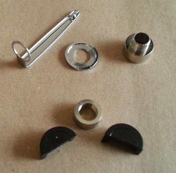

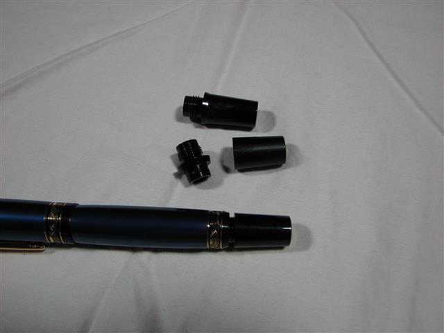

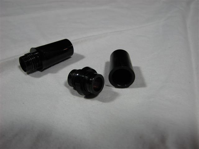

Here is a picture to clarify what Smitty is asking about. It sounds like Daycom says that they are supposed to be glued together at the factory. In the 3 examples shown below there is actually no evidence of adhesive so I'm thinking that it may have been missed for whatever reason.
So far I've tried blue locktite and CA. Locktite didn't hold and CA had a bit of squeeze out which ends up ruining the finish.
Smitty has been great in helping track down this issue and I appreciate his leg work. Hopefully this isn't a wide spread issue and just a bad batch which will happen from time to time with anyone.

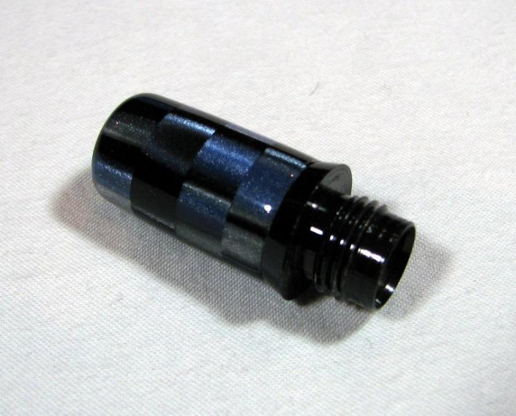

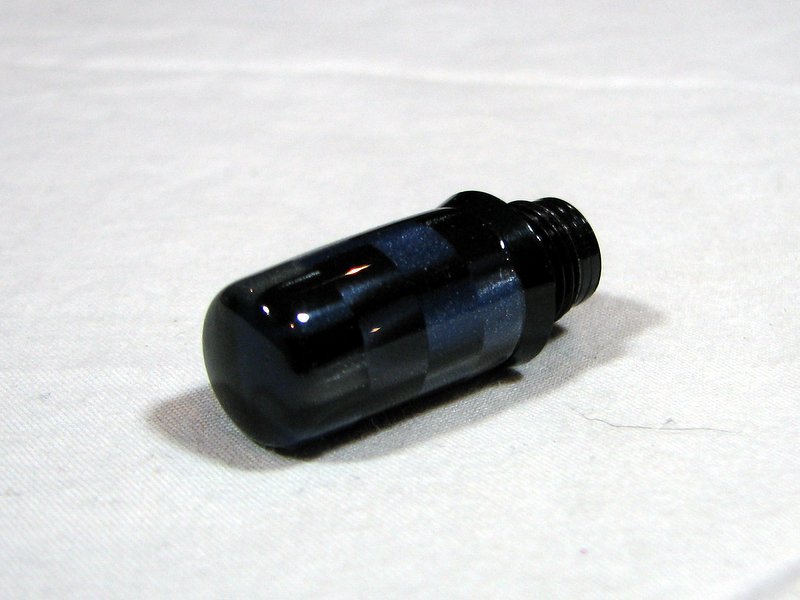

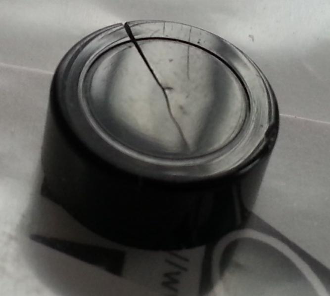

Like the first one (first + 2d pics), or like the second one (3d pic)?

For that issue I highly recommend pulling the assembly apart before pressing. Then you can just press the threaded insert first and then re-attach the clip and finial.

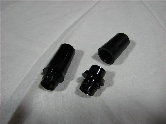

Hi Carl,
Seems a bit complicated. Both finials above were returned from the same customer (my only Ligero sold so far). The second one (3d pic: entirely splitted) was returned last year with the following body's finial (we don't see it but the finial is broken), dismantled like yours is. The girl told me this happened after a drop of her pen on... her desk... Quite bizarre isn't it?
Anyway, I replaced both finials at no cost for her. A few months later she came at a craft fair where she presented me a new splitted finial (first + 2d pics above), that is the finial I already replaced. Justification: the finial was broken by itself... Again I was dubious... But again I replaced the finial at no cost for her. After the issue raised by Le Roy I don't know what to think.

This picture looks like the issue we are addressing right now...the first post you made looks like a different problem...it is not terribly uncommon for some pens to break when dropped...
I agree with you but maybe not so common when two pieces located at opposed ends (cap's finial and body's finial) were broken at the same time from the same drop... on a desk...
Anyway, thank you LeRoy for assuring such an after sales service. This again honors you.

The pictures in thread #7 and #10 illustrate the problem I'm concerned with. Perhaps they should but I wouldn't hold my breath waiting for them to do so.:wink:
Leroy,
In fact by examining again the pieces illustrated by me above (posts 8 and 10) and returned by one of my customers I'm sure now they're unrelated to the issue you raised in this thread.
The 3 pieces are broken. Not visible on the pic (at post 10 above) but the finial is broken. And if the thread did separate from the finial it should have been after an impact.
Of course, I don't know for the rest of the Ligero kits I purchased from you but as for the issue adressed by me here it's IMHO this of a disturbed customer one (*)... :biggrin::biggrin:
(*) Do you know if Dayacom can provide a solution for this issue... such as replacing customers???...:laugh:

After some playing around, I'm going to start replacing these with matching material from the body. I did a successful rear section today and may take one of my parts kits and see if I can do the cap section as well. It's a nice upgrade touch.
To fix the rear section, it looks like you can just ream out that hole a touch or shave down the metal piece a touch and use some clear epoxy. A 3/8 drill bit to the plastic side going just the depth of the insert gives you enough room for a coating of epoxy without forcing it all out when you join the 2 pieces. A collet chuck comes in handy in this case :biggrin:

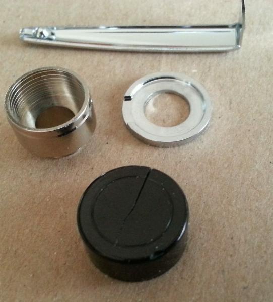

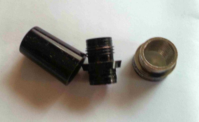

Here is one of the fixed finials. Unfortunately I won't see this customer and her pen again until Wednesday so this is a surprise upgrade for her.

We don't make Ligeros, but we have had this issue with similar kits before. The way that we glued the end cap and coupler together was to put a single small drop of thick CA up into the end cap (NOT ON THE COUPLER). Then we simply pressed the end cap and coupler back together. Since only a small amount of glue was used and it was not on the coupler and away from the edge of the end cap, there was no squeeze out. Also, rather than assemble the pen immediately, we leave these sub assemblies in a well ventilated (moving air) location for a day. This mostly ensures that the CA doesn't cloud the piece as it off gasses.

Sounds like a good approach to me. I think it would also work with epoxy but you'd probably need to remember it when you were mixing epoxy to do something else since it would take such a small amount.
