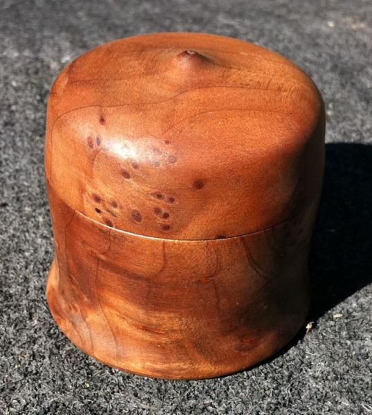

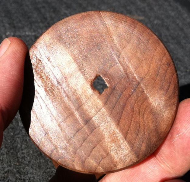

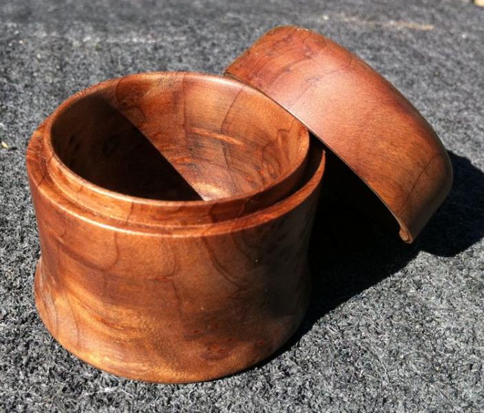

Here is my first. Redwood, 2-1/4" tall, 2-1/4" diameter at the base.
attachment.php
attachment.php
attachment.php
Ohh, ok. You can call it a lidded funnel, then!!

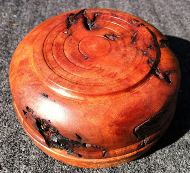

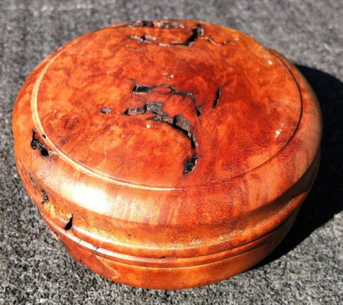

Lidded box #2
Red Gum Burl (from Nolan), 3-1/2" diameter, 2" tall, finished with beeswax.
attachment.php
attachment.php
attachment.php
attachment.php
Hint, DON'T rub on beeswax when you have voids in the wood. It took me DAYS to pick all that wax out of the gaps.
Yes, I need to resand it and refinish it. Dang those close-up pictures!!

Too much wax, simply gently heat the wood and roll it over a piece of paper towel. Reheat if necessary.
Nice lidded boxes. Keep up the good work. That funnel opening could be made to hold a matching finial.
gketell
Local Chapter Leader
Dec 15, 2006
2,772
Pleasanton, CA, USA.
Yup, that is what I did after I dug out the biggest chunks.
Unfortunately the hole is on the bottom so it would be pretty hard to balance the box on a finial! :biggrin:

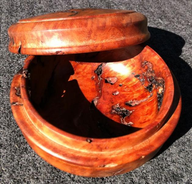

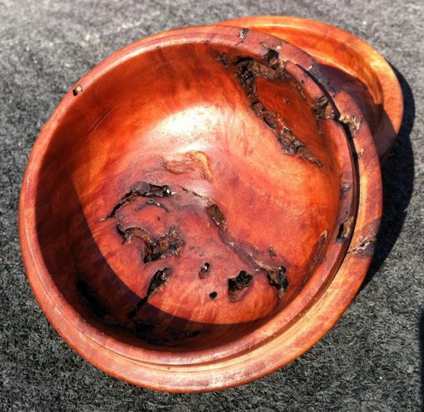

Dave_M
Dec 10, 2005
769
Clovis, CA, USA.

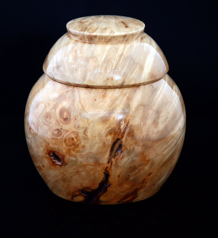

I updated my lidded box pic. Here is the lidded box I made for our challenge. Made from Big Leaf Maple Burl. My first non pen / stopper. One of the many things I learned from this is I need practice using my gouges. This was a lot different than turning a pen.
