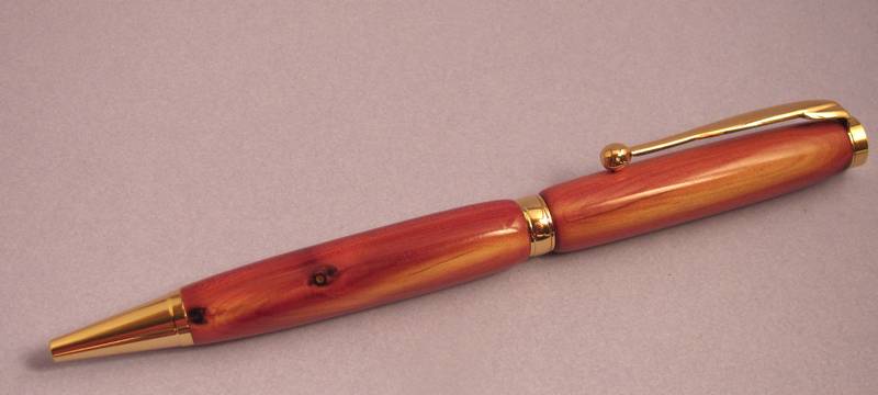

I am doing more or less what you describe only with some dead cedar branches, perhaps 1" to 1.5" in diameter. The inside is a nice cedar-red in the center, with varying degrees of white sapwood on the outside. There are lots of small inclusions and dead twig nodes in my branches which provide for lots of character in the blanks. I drill them slightly off center to expose more or less of the sapwood as desired.
