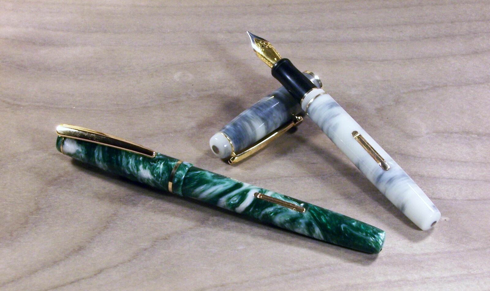

You need to buy a lever and a lever box (they should suit each other), a J-bar and a sac (they should suit too), some shellac and baby powder. R. Greenwald or the Pendragon are your friends. And after some trials and errors, this is it!

Yes, depending on what they get as old stock, it can be expensive. Check here, they are much more affordable at Pendragons for the moment.
I cut the slots with a Dremel tool and hand files. As the lever box covers part of the slot edges, little mistakes won't be seen...
