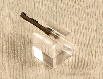

are you referring to something like this?

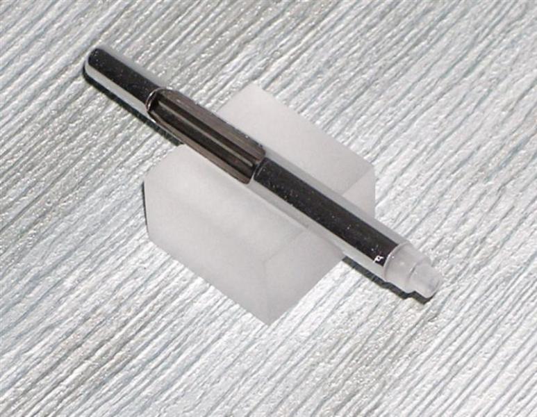

From my understanding of a lever fill, the lever (part of the pen body) pushes a bar (J bar) that squeezes a sac.
I have not heard of a "converter" that has a lever. another version is the aeromatic converter which is like this. It's a sac inside a converter that has a bar that you squeeze to fill. So your options, that i'm aware of, are twist, slide, or squeeze.

That's more of what I'm thinking of. A lever can be fabbed to press against something flat then against that sac I assume...
Are those available somewhere?

here is the description at the typhon site: A high quality ink converter for all pens that accept international size cartridges. This is a slider-type converter with a very narrow mouth, which will fit even pens with a slender barrel and section. Made for all pens that accept two short international size cartridges back-to-back or one long cartridge.
I have not used it and dont know any pen makers that do. I wonder if it's just a matter of dexterity when we've got a nib dipped into a bottle of ink, twisting a know over the hole or pushing the side and sliding as we try to hold it steady?
We all tend to use the classic screw converter or make something of our own design like fountainbel or bgray.
