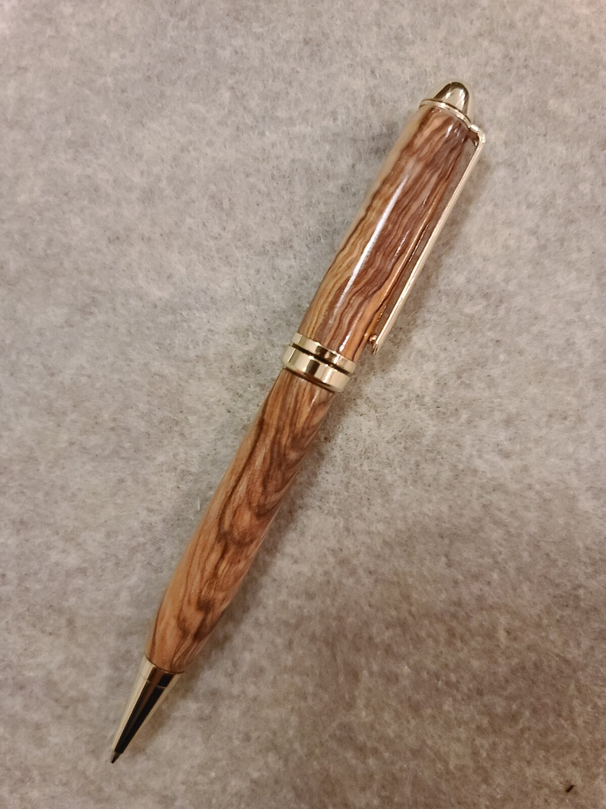

In my vast experience (all twelve pens :cool:) no kit is that much harder than another. As a beginner I made twelve pens using four different kits for Christmas gifts this year. By far, the hardest part is learning to turn the blanks and all that involves. My kits ranged from a few bucks to over $50, but actual assembly was straightforward on all of them. I hear there are kits out there that require making a tenon for the clip to go into; I suppose that'd be a more advanced pen.
The European pen requires a tenon for the ring and it is a pain. I don't think one kit is typically easier or more difficult than the next. Slimline kits will quickly point out your mistakes. The good thing is they are inexpensive. I make a pen out of lignam Vitae that was once a bushing in a dam. It is hard and brittle, the grain is very open and much more difficult on a smaller diameter than a larger one. I made three for the big bosses at Georgia Power company at Christmas. I had to get the tools out to cut off the finish three different times on one of them and refinished it a total of five times to deserve the exit of my picky eye and go in the mailbox. If you did twelve at Christmas get ready you are about to be really busy. I turned my first pen just over a year ago. I have turned about 500 since. Now I have a mobile trailer I only turn in. Great at shows. People love watching it take shape just like we do. The first picture if I upload correctly is the European that is a pain the other is the three pens from the wood on the dam
