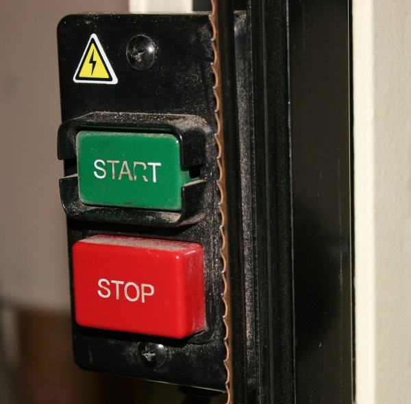

I like to think that I'm pretty safe in the shop. I'm always very conscious of where my hands are in relation to moving parts when I'm in the shop and have always taken the position that if you keep your eyes on the ball and your brain in the game, you pretty much cannot be inrured in a woodshop. This afternoon, I took my eye off the ball.
I was cutting up a few logs on the bandsaw. The blade clearly had become dull, so I told myself that as soon as I finished the cut that I was on, I would stop for the evening. The blade cleared the wood, so I reached over with my left hand to hit the stop button, as I have a thousand other times.
This time, however, the now dull blade slipped the upper wheel of the saw as I came to the end of the cut and I didn't immediately notice. I noticed because my left index finger came into contact with the still moving blade that was now sticking out from it's normally gaurded position, a centimeter from the bandsaw's stop button.
Three stitches later, here I am, with one more little thing to be wary of when working in the shop.

What's wrong with this picture?

Actually because the blade slipped off of the tire, it cut through the switch cover. If I am not missing my guess, that is a Jet 14" bandsaw.
sbell111
Jan 16, 2008
3,465
Franklin, TN
It's a Shop Fox, but probably a similar design. It didn't cut through anything, except my finger. The normal condition would have the blade recessed about an inch in a thin channel. Since it slipped off the top wheel, it popped out.
Man that picture sure looks like a case of real poor design, and a potential for a huge law suit.
I haven't done the research, but I bet that 90% of our bandsaws use this design. I base this on the fact that my saw is a (better) twin of the Grizzly G0555 that sits in many of our shops.

Regarding my switch, It's not really any closer to the blade than on any other bandsaw that has the switch on the riser. Shop Fox, Grizzly, Jet, Delta, Powermatic, Ridgid, Steel City, and other manufacturers all use this design. During normal operation, the blade is down in a this channel and cannot be easily accessed. What happened to me was a freak accident. Had I realized that the blade had slipped the top wheel, I would have been on the lookout for the danger. My ignorance of that fact combined with my not checking to make sure that it isn't an issue every single time resulted in my injury. Now that I am aware of the problem, I know to be wary of the issue and will not sustain any similar injury.
I wonder how many of us own similarly designed saw and never knew that this could happen. How many have walked out to their shops and taken a look at their bandsaws and noted that theirs is of the same design?

I have a Rikon with the same switch, but the blade is behind metal doors that latch well and cover the top and bottom wheel. I recently had the blade break, but it didn't come out of anywhere, it just stopped. It is a very safe design. I think that I would put a cover over the channel as protection.

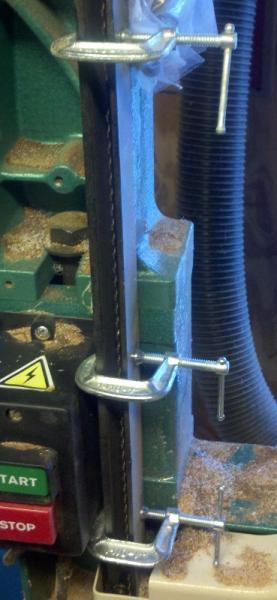

Wow... Here is my temporary fix. Thanks Steve for "Taking one for the team"
Tom
Looks like the blade is facing the wrong way or am I looking at this wrong?
HMM??????:confused:Looks that way to me to. Not sure whats up with that? I hope this hasnt been running in the wrong direction the whole time?
Nevermind. The blade is upside down because it hasnt gone over the top wheel .Once it rotates over the top wheel it will be facing downward. Almost had me there:biggrin:

Can you move the switch? The design seems flawed to ever have a switch that close to a blade that is not guarded well. It seems like the switch should be closer to the table.

I suppose that some people may choose to move the switch. I will not do so. In my mind, the blade is properly guarded during normal operation.
In those rare times when a blade breaks or slips the top wheel, you normally would be aware of it happening and know to look out for a potentially dangerous situation with the tool. It's only the very, very rare time when a blade slips the wheel (and does not break) AND you don't notice that the saw becomes dangerous. I will mitigate this danger by simply being aware that it can happen and looking at the switch prior to reaching for it.
