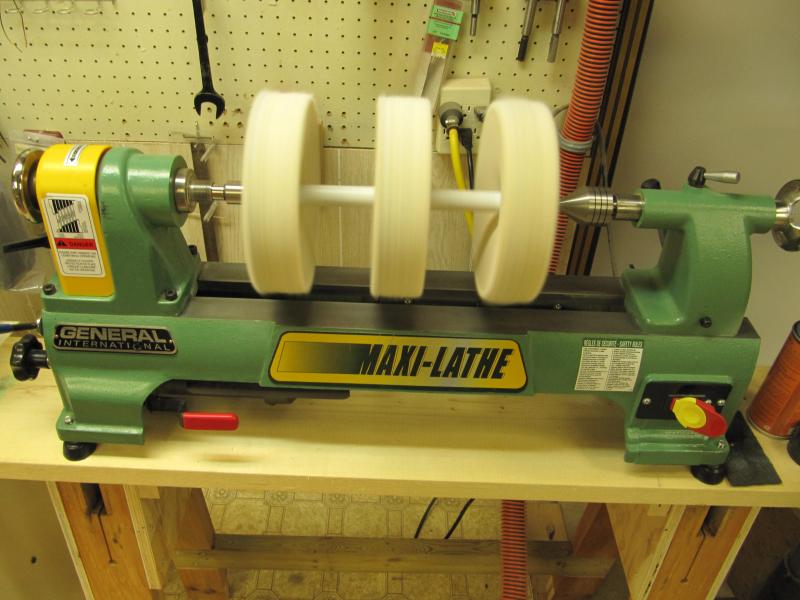

Hi Andrew; This is my dedicated buffer, built entirely with my own 2 hands!:biggrin:Not much cheaper than if I had bought the 3 wheel Beall buffing system. I just wanted to do it myself.
I use the buffing compound by Caswell www.caswellplating.com
515-6163 Plastic Glo (Ultra-Fine Dry), and 515-6165 Plastic Buffing Extra Fine.

Mack, I am envious of that set-up, although your buffing lathe is A LOT better than my one lathe.
