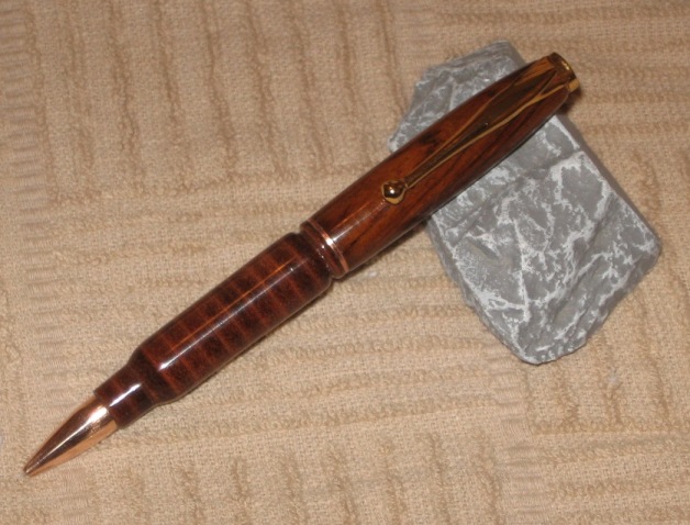

Here's a couple I did many, many, many moons ago - Leather barrel&clip.JPGLeather Bullet.JPG
The only stabilizer you will need is a little thin CA.

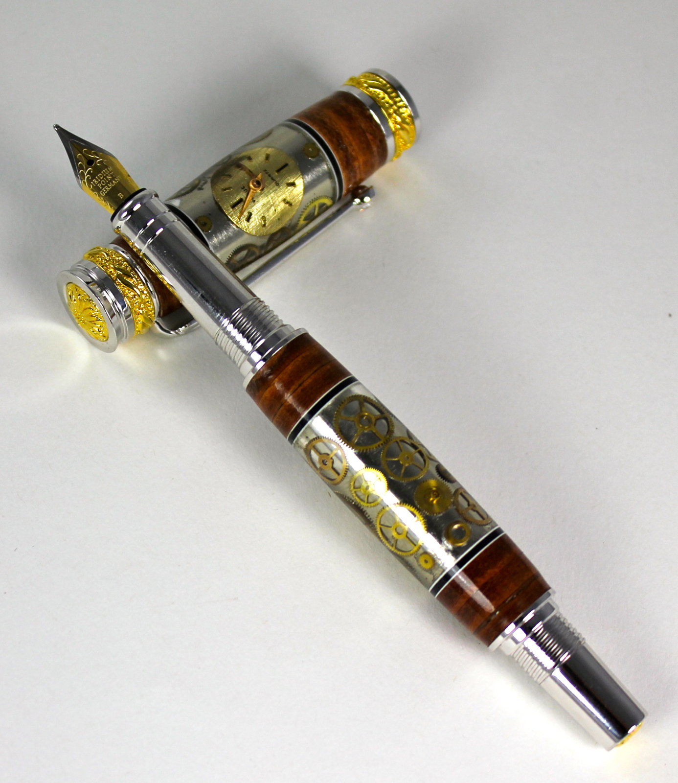

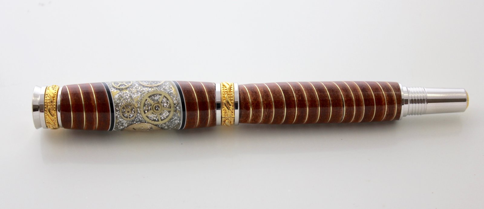

Ron Blais has three pens (MAPG and 2 MPG Best of Show Winners) in the IAP Collection with segmented stacked leather. He also used soaking the leather in CA.

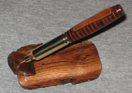

Shooter, I made one out of an old saddle girth strap that broke on me. I took a .50 caliber shell & cut off the primer end. Then I filed the cut end to about a .45 degree angle. Placed the small end of the shell in my drill press. It cut out perfect circles of leather to stack together. Glued each circle together until I had a stack long enough to turn. Made a slimline pen out of it. Leather works good.
