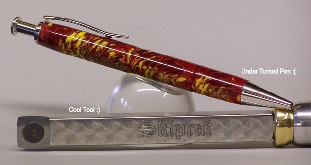

So I was eager to have a go with my new Customised Woodchuck from Bob and Ken:biggrin:. But as a complete novice with this kind of tool, of course there was a little learning curve. Here's how I got on.

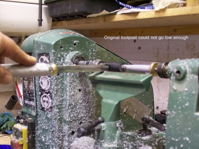

The very first thing I discovered was my original small toolrest on my poxy lathe wouldn't go low enough to get the cutter anywhere near the centre line:mad:

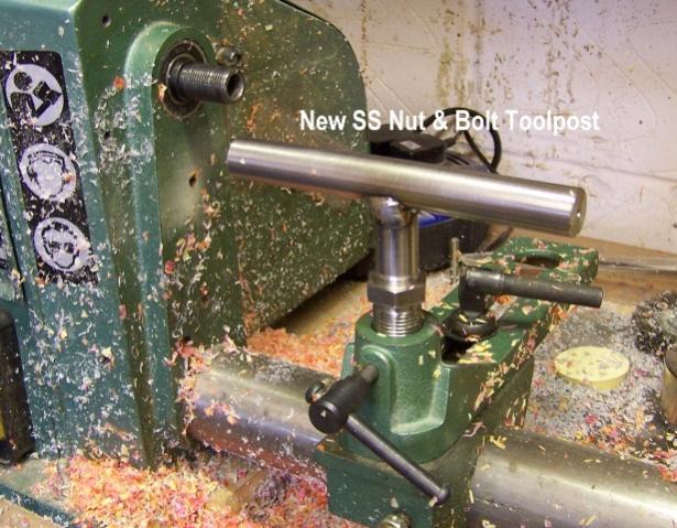

Ok, so I've wanted to make a nice round stainless one for years, so knocked one up from some pretty big bolts ( ignore my version of Bird Poop' welding)

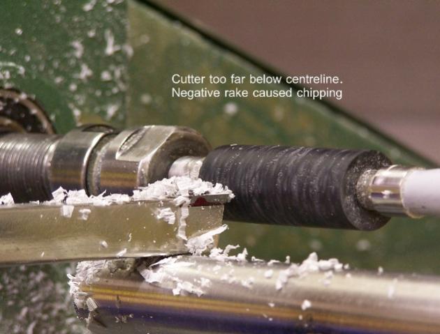

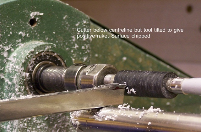

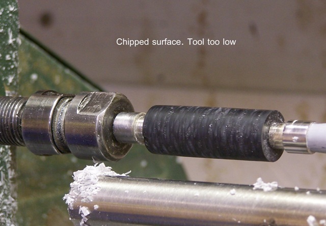

I set this up to the instructions from Ken, but as you will see in the pics, I couldn't get a nice crater free surface. I'm sure as I practice, that I'll get nice long ribbons when I lower it. Or maybe someone can see what I was doing wrong from these pics:confused: But I do get short ribbons:biggrin:

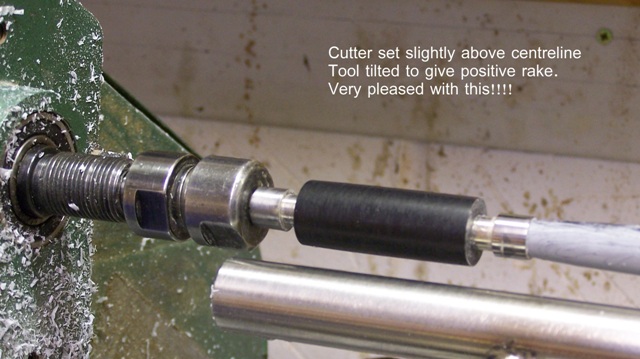

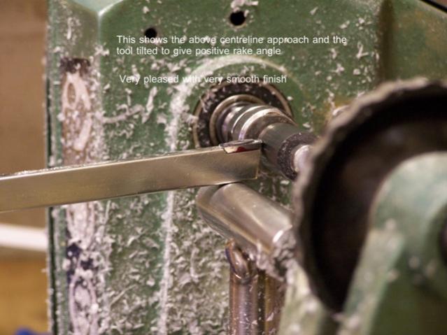

I tilted the cutter to give a bit of a positive rake, above the centre line and the result was fantastic. I could easily start sanding from at least 600grit.
There are captions on the pics.

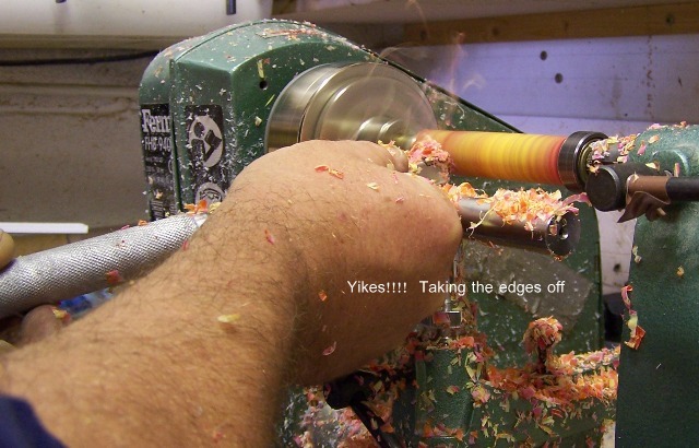

This little tool can eat blanks for breakfast, but I soon got over my nerves and eventually held it quite lightly. When I started, it was white knuckle time:redface:. For someone like me that has never learned to use a skew, it's a Godsend and I love it:biggrin::biggrin::biggrin:
If I can, then ANYONE can:rolleyes:

Skip, I have found that by angling the cutter just a hair, I get one continuous ribbon for the length of the blank. It just takes a little playing with and you will see what I mean.

I guess I hold a chisel ( or file ) like this by habit. It keeps my left arm away from the chuck. :wink: But do you really think this could be causing the chipping?:confused: I think I just need more practice:rolleyes::biggrin:
