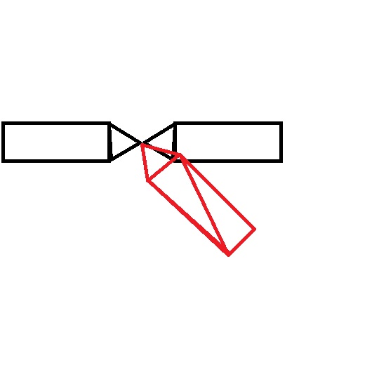

If the points line up ... it means nothing. I can make points line up and the two axes can be way out of alignment. For example:
Very true. Good point. They have to be co planar.
It is still doable using the centers and a straight edge though, assuming your lathe has two faces that are supposed to be co planar.

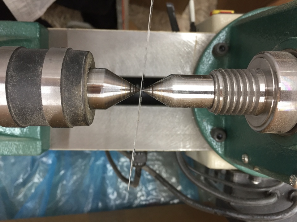

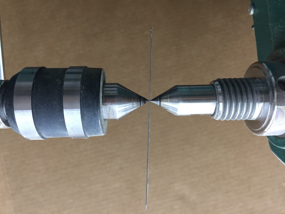

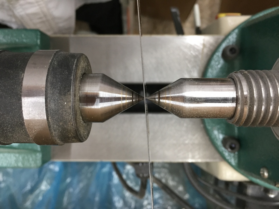

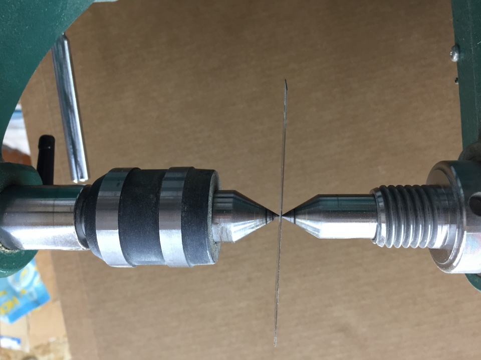

Here are 4 picks of one of my Grizzly 12/20 bench lathes. I put a box cutter blade between the live and dead centers instead of a rule or feeler blade. First 2 pics are from in front of the lathe. First with the tail stock pulled towards me and locked down. Second is pushed away. You can see the tail stock is a little low from the slight tilt of the box cutter blade. Pics 3 and 4 are from above with 3 being pulled towards me and 4 pushed away. It show that somewhere between the two the tail stock would be centred. What the doesn't show is if the axis of the head and tail stocks are the same.
Dang the pics from in front of the lathe are upside down and first 2 and last 2 arein reverse order. Phones. :(

If you check with the rear center next to the tail stock and then extended, it will test if the there is twist to the tail stock relative to the head as in the drawing posted. If they are out of plane the extending of the rear will quickly show this, not very likely unless there is significant slack.
