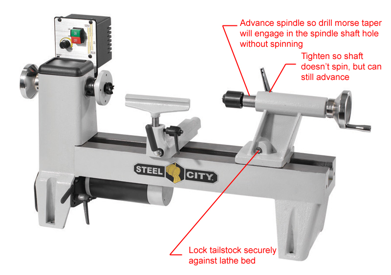

It also looks like the tailstock isn't completely tightened against the bed, and the tailstock spindle lock might be too loose.
  1. Clean the morse taper spindle shaft hole and drill morse taper shaft;
  2. Extend the tailstock spindle as mentioned above to make sure the morse taper of the drill chuck is seated firmly in the hole of the tailstock spindle shaft and the morse taper doesn't spin;
  3. Tighten the tailstock spindle lock so the tailstock spindle shaft doesn't spin in the tailstock; and,
  4. Tighten the tailstock against the bed.

  1. Tighten the tailstock spindle lock so the tailstock spindle shaft doesn't spin in the tailstock; and,
From what I see John nailed it with the tailstock lock. The chuck and tailstock quill are spinning together. The morse taper is not slipping so that isn't the problem this time. There should be a slot cut along the side of the quill that the bolt of the lock sits in. It prevents the quill from spinning in the tailstock. Get the quill aligned with the lock and turn the lock in until it touches bottom and then back it off 1/8 to 1/4 of a turn at most. If the lock has one of the spring loaded adjustable handles set it so that it is pointed down when backed off, so that it doesn't loosen more with vibration. If you continue to spin the quill in the tailstock they will wear and the slop will cause more turning and drilling issues.
These 2 beat me to it. The fact that the entire quill is spinning means your lock has backed out too far and is not engaged in the slot.

That's because the quill lock is not engaged far enough.
This particular issue has nothing to do with the taper or seating or anything but the quill being allowed to turn freely in the tail stock. Run the quill out far enough to find the groove. Then line that up with the cam lock on the back side of the tail stock and advance the lock until it engages into the grove. Then just back out a 1/4 turn until the quill moves freely in and out of the tail stock without spinning.
