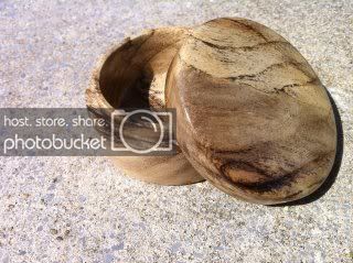

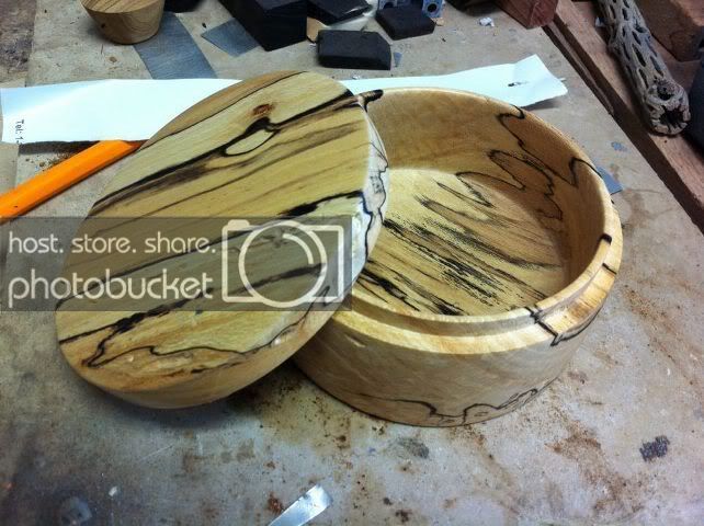

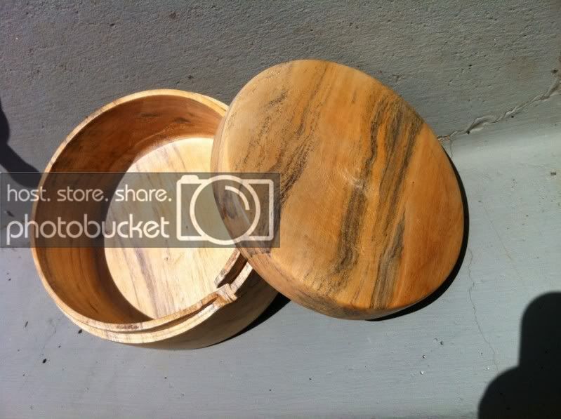

I am thinking it is time to upgrade to a larger lathe. I currently only have a Rikon Mini. I have been trying my hand a larger items lately(not by mosts standards) but for my little lathe its a dance around the shop. What does everyone recommend? Here are what I have been trying to do.
