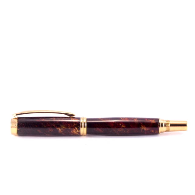

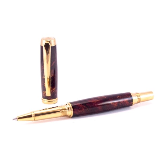

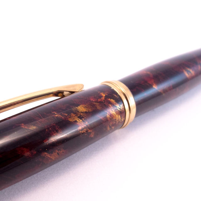

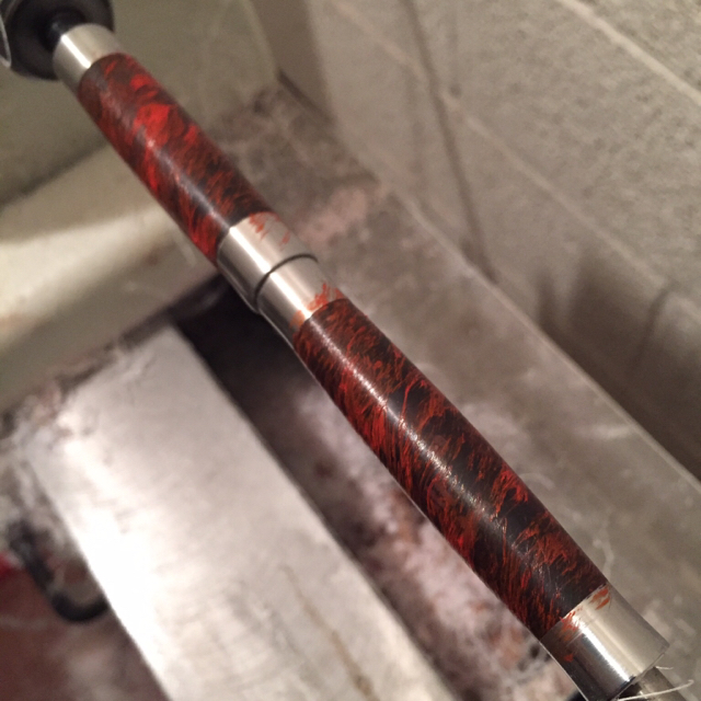

This is my latest attempt at a Japanning look. I think it turned out good. Here a very brief description of the process. Couldn't even tell you the amount of layers cause I lost count. Lots of time but totally worth it.

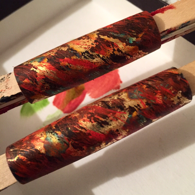

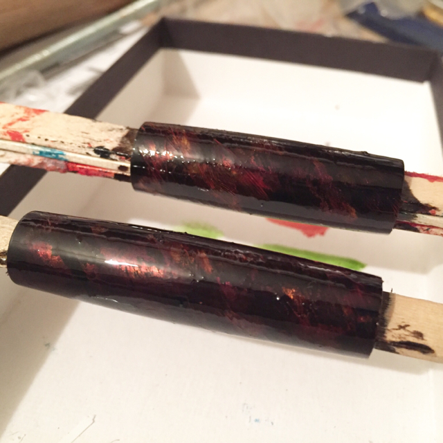

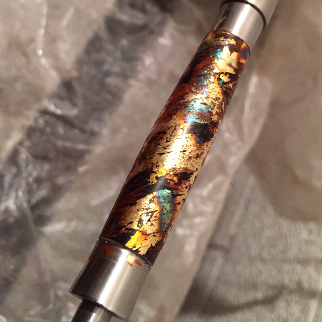

Started with a transparent acrylic blank. Turned it past the bushings cause I knew I was going to build up the material with layers of painting and ca. There were a ton of layers that went into this. Each a very transparent paint and then some ca and painting again. Wanted to get a lot of depth. Added Italian gold leaf , more paint and the final layers were a transparent brown. Then sealed it all with CA. I think it turned out great. The gold shoes through well when the light hits it right. One day I will learn how to use actual urushi.
Thanks for looking.
Jon

Very impressive, I love it! The last layer of brown paint makes the pen very elegant.
What kind of transparent paint do you use ?

Glad you all like it. Thanks so much for your compliments. Learning a lot in creating this look.
I wish I could do a process for you all but it is hard to say. I use so many different types of paints. Sometimes varnishes and oil paints, acrylics, inks, and others I find. And I keep putting layers on until I like the look. Just the same thing I do when I paint a painting. No real process just making it up as I go. If any of you all are ever in Italy look me up and I can show you.
Hank. I totally wish this had a better shine. The pics do not do it justice on the shine. It is finished with a CA finish and has an incredible glasslike finish. I try to photograph them without as much of a reflection so that you can see the material. I am glad you liked it. One day I will dabble into the Urushi. Maybe after I visit Martin in Switzerland. Hopefully sometime soon.
Jon.
