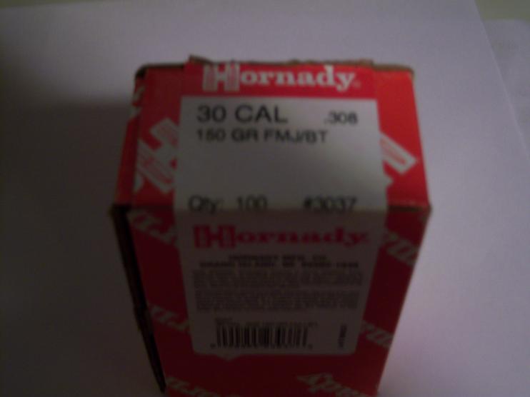

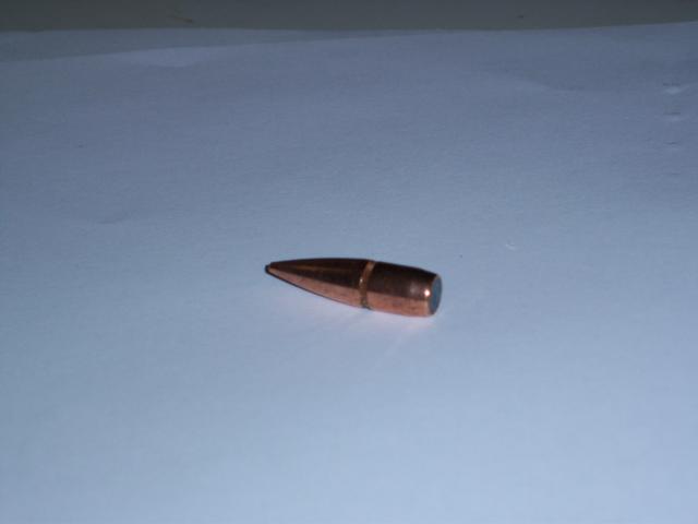

I use the Hornady 30 cal 150 gr. full metal jacket boattail stock # 3037 Drill a hole in the point using two jacobs chucks, one dead end one live end. About a qaurter of an inch into the point then melt the lead out. Here are a couple of bad pics of the box and bullett. bulletredo.JPG
