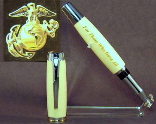

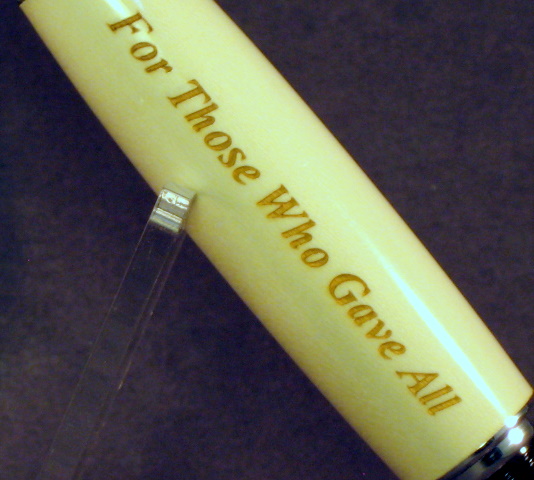

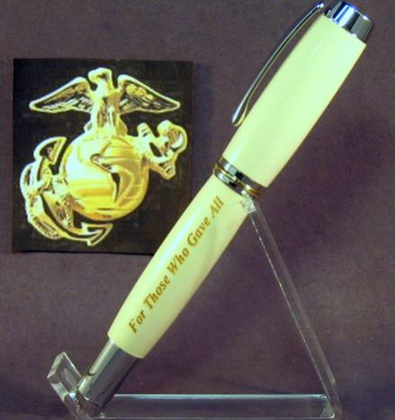

Ron , I made some pens for some Marines , and had them engraved . I used Holly , and didn't have to fill the engraving . Take a look . If you want and need some blanks , I have some to send you . Just let me know .
