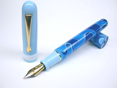

Hi Tex, thanks for posting. I don't want it for kit pens - I want it to use on my custom fountain pens. But to answer your question, 14mm threads wouldn't be that large, but then again would depend on the style of pen you were using it on, and the thread treatment-- the difference in the transition from the barrel to the threads. I use the larger diameter thread and make the threads the same diameter or close to the same diameter as the barrel instead of having the abrupt change in diameter from the barrel to the threads.
On most of the kit pens I think mfg's just choose to use smaller thread sections on them to cut down on cost and the number of different parts they have to make. I think it compromises the look of the pen. Especially when they put those little nibs on them. The smaller diameter thread and nib sections on some make them look too much like an out of place add-on instead of being a part of the pen. Also makes them look top heavy (good example would be the Majestic Jr). But maybe that's just me.
I make ALL of my own FP parts, so I can make all my parts to the size I need for the style pen I want. It doesn't make for as beefy of a pen as you might imagine. To the contrary, it makes for a very comfortable pen (I've even sold some to female clients who purchased them for themselves). If you look at some of the very high-end fountain pens like Bexley, Conklin, Conway Stewart, all of those have barrels well larger than 14mm and have similar treatments with thread sections that are the same diameter as the barrels. Conway Stewart's Churchill, Winston and Bard FP's all have 15mm diameter barrels with that thread treatment.
I mostly use this thread treatment on my pen styles with what I refer to as "oversized caps" (vs "smooth caps" styles where the cap and barrel are the same diameter and a smooth transiton from cap to barrel and needs that steped transition to the threads--- but that line has blured over time). On these the barrel diameters are typically about 14 to 14.5mm.
I'd just like to be able to add a multi-start thread feature to these pens, and thought 14mm would be about the same size as the SAE I'm using now. But that's one of the reason I posted here - to ask what other used (and hopefully not have to pay the full cost of mfg all by myself). But I didn't think I was alone in using larger size threads. I was really hoping that someone already had some, so I find that rather interesting that no one else might not.
I attached a sample pen to this post. If you would like to see other examples (and the dimensions), go to the link below. The two lower groups of pens at the bottom (the orange, and the two solid colored cap pens) . Those styles have larger threads (larger than the M12).
