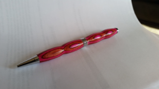

Here is my latest kit pen, I am trying to master my lathe and tools first! Then within the next couple of months...I'll be ready!
