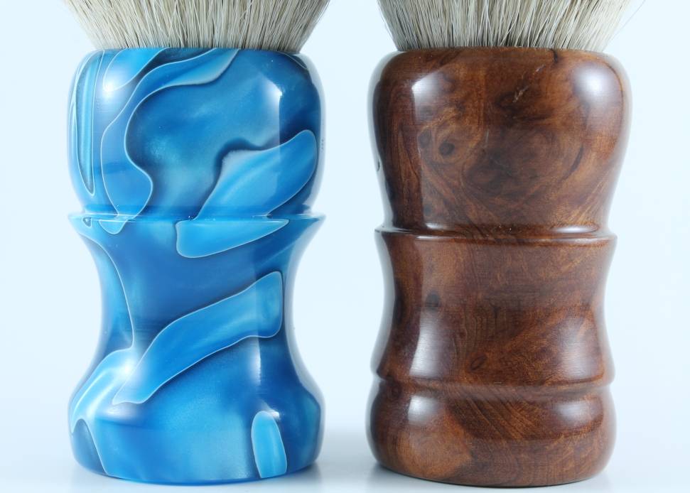

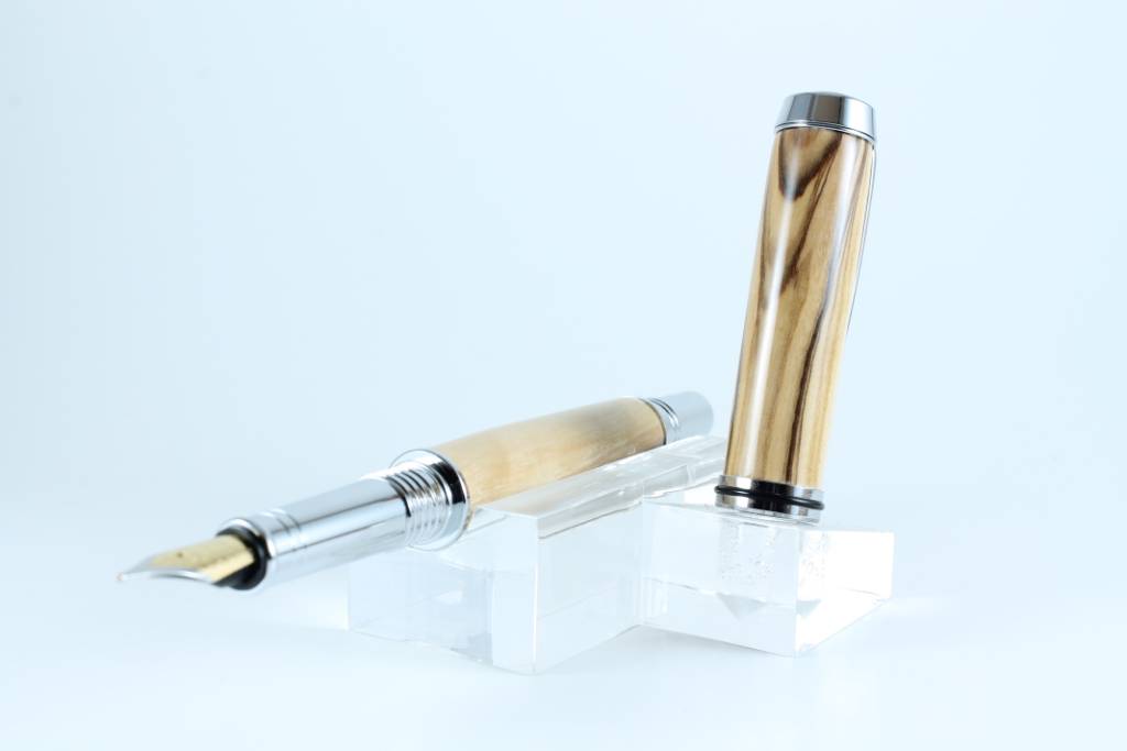

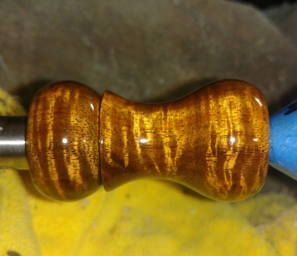

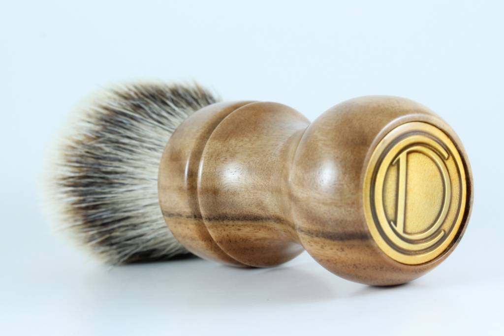

Thanks for the warm welcome! I appreciate the info regarding my question about using wax, as well as the pros and cons of different types of lacquers. You are correct that I'm using nitrocellulose lacquer. I read a lot of good reviews about the masters magic stuff, so I thought I'd give it a try. I will say that I've been very impressed with how the projects I've used it on have turned out. There doesn't seem to be a huge learning curve with it. Regarding using lacquer for a project such as this that comes in contact with water regularly, I've made it a point to mention that the brush should be completely dried after each use. I always make sure to completely coat the inside of the hole for the brush knot with the two part epoxy that I use to set the knot with, so hopefully long term durability will be of little worry.
I would certainly be open to trying polyurethane to finish with. I attempted to finish a razor handle and brush/razor stand with some Helmsman Spar Urethane spray a couple of months ago, and it was a complete disaster. Couldn't get a smooth finish. If buying or even mixing up my own "wipe-on" poly would be a better method I'd love to give it a shot. As I said before, I don't really mind having to wait a bit to buff if need be.
Here are a couple of examples of brushes or handles that I've finished with the Masters Magic.
Sent from my XT1585 using Tapatalk

Very nice. Like the shapes of the brushes. I believe wood will always look nice with a lacquer because as I said it gives depth to the finish. With pens you are not as prone to water as with shaving brushes. Acrylics always make good alternatives for material choices. You do as you wish but remember the cool beverage dripping droplets on that wood table. That is why you are encouraged to use coasters. Good luck.
