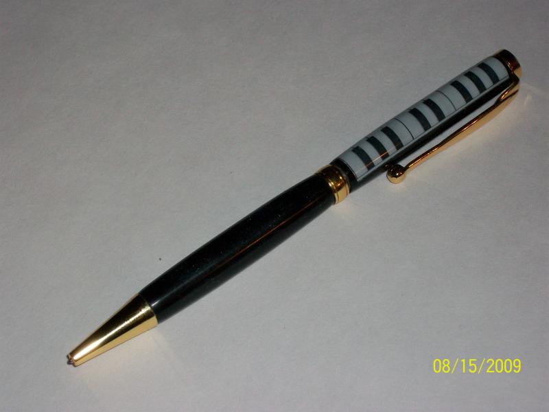

Waterslides work well except when the surface is not straight, as in wider in the center than on the ends. I made a panio key pen with a waterslide. Turned out pretty good. What do you folks think?
