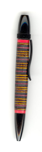

I was browing photos of my pens and came across this one I did awhile back. It is made from leather disks a-la Kenn Osborne. The disks were cut out with a hollow punch as was a hole in the center. I stacked the disks and brass tube on a bolt between washers and after adding more disks than needed, I squeezed them toghther with a nut. I removed them and restacked them with an epoxy coating and glued them together. The leather was different colors and purchased from Hobby Lobby as a bag of scrap. I turned them using a skew and scraper. Sanded and finished with a coat of Crystal coat...which was what I was usnig at the time. Others have been finished with CA. Thanks Ken for the motivation and tutoring.
