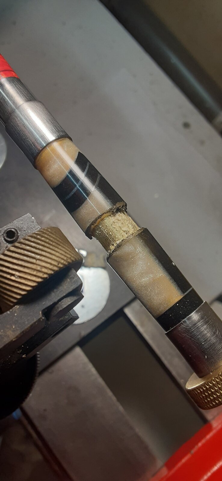

I just bought a clamp type knurling tool. I turn more metal these days than plastic. A few weeks ago, I made a tactical pen and was a little disappointed that the tip end did not have knurling. My first thought was to try knurling the bottom of the blank. I have some turned blanks that I can experiment on, stay tuned...
carlmorrell
May 14, 2013
693
Cary, NC
Yeah, not a good idea. As soon as I turned up the pressure, the blank exploded. Based on my expertise an exhaustive tests (1 try), I would say leave the knurler for metal.
