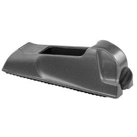

larryc
Oct 2, 2009
1,135
Mableton, GA (Near Atlanta)
