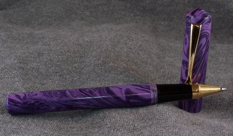

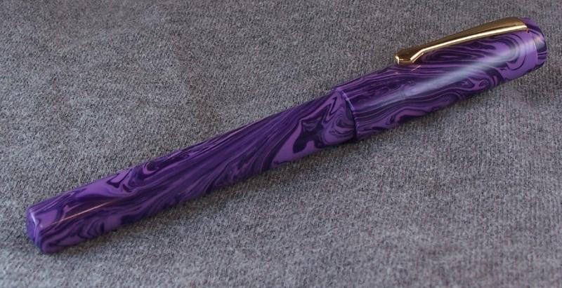

I have here today a kitless trustone pen. I discovered that this stuff does NOT like to be threaded. At least with the tools I have. I borrowed the clip from a "classic" pen. Comments welcome.

Nicely done. I really like the color. On difficult to thread materials I usually make an ebonite insert. Saves a lot of aggravation.

Hans, great looking pen,Charoite is a bear, I have a 2 LB piece of the Non Pliable material, I made one pen out of it and that was enough for me!!!

Very nice! That would be the Charoite?
ExoticBlanks has it listed as slightly harder than the usual trustone. What kind of trouble did you have?
I am making two Trustone Kitless pens myself, one from Chilean Lapis and one Larimar whose look I really like. I've had no trouble threading the Larimar and it's one of the softest Trustones. We'll see about the Chilean Lapis tomorrow. It seems to be as hard as the Arizona Jade, so I've got the Trustone hardness spectrum covered.

Kaspar, you would be correct, it is charoite. when I tapped it after I put the threads on the outside (12mm triple tap) it busted part of my threads.

Wow - kitless TruStone! Nicely done. That is a challenge indeed. I'm not surprised about the threading difficulties. I've never tried to thread TruStone, but given the feel of it when turning it, I would expect that it would be a little crumbly under tap and die.
So, all that much better an accomplishment - a beautiful pen indeed!
