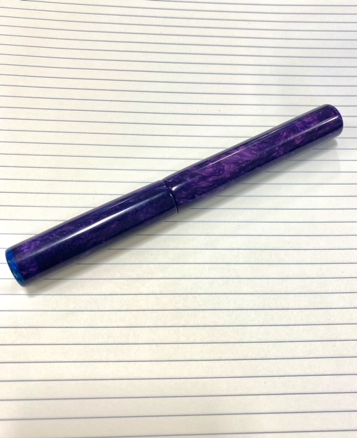

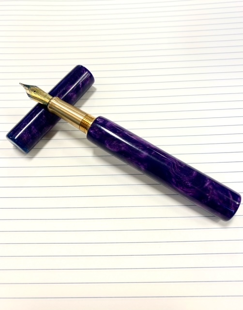

I have been making pens a few months and love it, I do want to move to kitless pens and turned my first closed end fountain pen using a section and cap glue in insert.
I make my own alumilite clear blanks, and love this part as well but not sure this is the best product for the sections, seems ebonite is better option.
I am from the US and love the #6 size Nib
What do you use for sections, and where do you get it from?
What size tap and dies do I start with? I prefer triple start.
Here is my first closed end pen with one of my first resin castings.
Thanks in advance for any help.

That is a beautiful pen, Denny !!!
Thanks for showing !!! .
Looks to me that you are off to a good start in venturing down the kitless trail !! . Just carry on, making changes as needed to get where you want to go.
