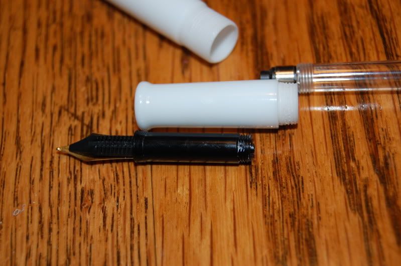

Unfortunately I am not one yet. :confused:
I have went for a 2nd attempt at it and I guess I need to back up and read some more. I think I made my feed section to long. as My Piston does not meet my housing to lock in. I also learned that the feed section must fit inside the cap.:redface:
I also am still having threading issues on my PR blanks. Should I just break down and buy some alumilite ones?

Seems great to me. If I only could make one like yours... Not for use but to contemplate it...
As for the long section don't worry... even the expensive kits we're buying from some suppliers have this problem... yet to be resolved!
Personally I abandoned the converters. It's not the best, but is a solution!

I am no expert as I have only created a couple but I would get some Alumilite as it makes it TONS easier to thread! I am going to give PR a shot in the summer when it is warmer out just to say I could as I have done it before but not while it is cold!
You are learning more than anyone can tell you! Believe me! I learned just like you have.....I have drawings upon drawings of the front section trying to determine lengths and dimensions.....Don't give up the Front Section is the hardest.
