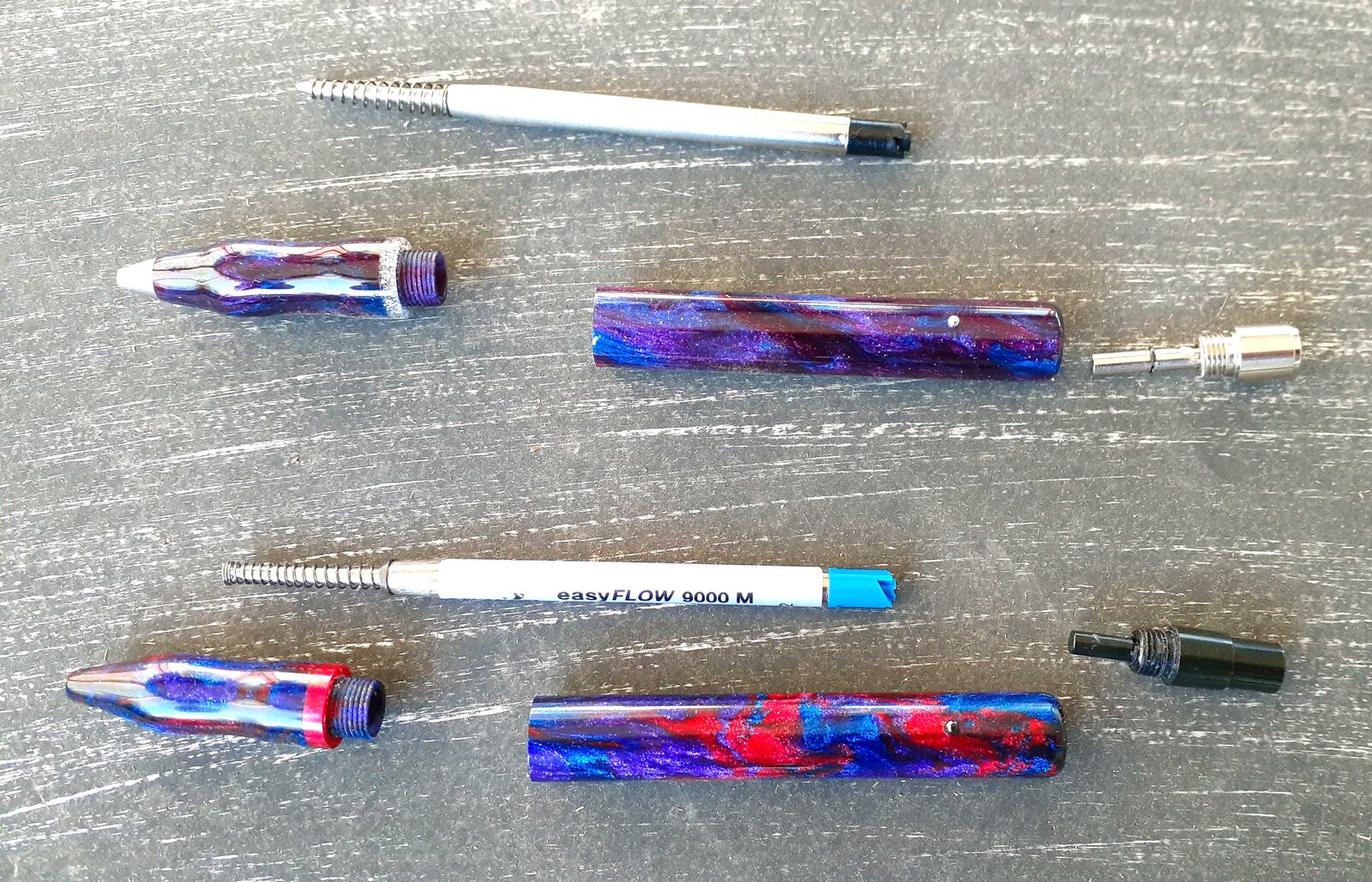

2 in a row for me.
Desktop Clicker #2
Blank is DiamondCast Orion accented with DiamondCast Moissanite Radiance.
Pen is about 5 1/8" long (130cm)
Stainless steel SKM-88
Stainless steel roll stop
Rhodium plated tip
Comments and Critique appreciated.

Very nice indeed ! ! ! . . . Both of them ! ! !
It would be nice to have the details of how you made these, please.
For example, what size are the brass tube(s) (if any) ?
Do the two portions of the barrel unscrew from each other at the decorative band ? . . . what size are the threads ?
It's nice to get these facts about the construction from the maker of newly-presented kitless pens.

This is beautiful and it's hard to beat a clicker for convenience. Nice blank, fantastic finish, really like the inlay.
Obviously, that was not a kit. Did you still use a tube? How did you thread for the clicker? Is the tip a screw on also, so the ink cartridge can be changed at either end?

Hi Mal & Todd.....
  • No tubes. Body is drilled 1/4" and tapped appropriately for the section or clicker.
  • The lower piece is a section based upon specs from an IAP library article & drilled to accept a Parker/EZflow refill instead of fountain pen.
  • Threads for the section are m9x.75
  • The accent is an Alumilite 'washer' which serves as both an accent and to finetune overall length adjustment (drilling OOPS).
  • SKM-88 clicker threads are m7x.75
  • Roll stop is a 2mm Stainless Steel ball-end headpin.
  • Rhodium plated nosecone is from Richard Greenwald & glued in place.
  • Finish is GluBoost CA
That PSI box of 50 blanks for $50 has been great for experiments and learning new processes.
Sorry I read and speak bullets better than text novels.

Thanks for those details, Rick.
If you can, please tell us which IAP Library Article you are referring to below . . . or in which section of the Library the article is filed.
Maybe it's in the section titled "Fountain & Kitless Pens" . . .
. . . . and possibly the article with this title ? ? ?
Kitless Fountain Pen
Thanks again !

Mal, I'll have to find it again. It was not those. It was more of an Order of Operations list with dimensions and bit sizes on a single page or in a single image.

Sorry, it was an image in a post. I used the Bock #5 dimensions as a starting point. My tablet doesn't play nice with posting clickable links so future readers might have to copy/paste to get the image.

I'll go through that textual description of the process and adapt to my needs as you did for your needs
I am doing something similar to you, based on some parts from a Berea Cigar pen kit but modified to become a single-barrel click pen with a
Schmidt SKM-88.
Thanks again for your very helpful responses to my questions.
