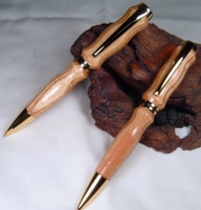

Ang, the best looking one I've seen is the Jr. Gent. You know what the FP & RB look like. BTW, it also come in a pencil (Schmidt mechanism). Here is a Jr. Gent BP & Pencil set.
<br />
Or you could've just looked at Jim in Oakville's latest post. Same set in curly Maple.[;)]
