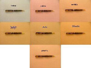

one of the first things I learned about my Digital camera was the light compinsation settings. different light sources add different colors to the image. I did a test with my camersa by taking a picture of a plain white piece of paper with the camera set on each of its various settings. this was the result. remember the photos where being taken under an incondescent light.
Image Insert:
11.44KB
Well that at least is a start.

Rudy,
the background is the same in all of them. it is a white sheet of paper. the subject is also the same. the only thing I changed was the light correction setting on my camera. from left to right top to bottom they are
Incondescent, Florescent 1, florescent 2, Daylight (outdoor),Auto, Shade,
and florescent 3.
the different florescent settings compensate for differing florescent lights, such as cool white. color correcting, etc. good luck figuring out just what florescent you are under. but knowing that this one setting can change the color of a photo this much helps alot in figuring out what is wrong with your pen photos. notice tha the Auto setting does not correct well in Macro photos. most of the Auto features on a camera will not. including focus in many cases.
even in th ecase of the first photo, (incondescent) with the picture being taken under incondescent light the paper comes out very Grey.
all cameras including digital expose for a grey tone. this can be eliminated with other methods of reading the shot and adjusting the camera. but unless you are taking pictures for a catalogue or something this usually would be beyond the interest of the average pen picture taker. knowing that you have to have the camera set for the right adjustment to get accurate colors is far more important.

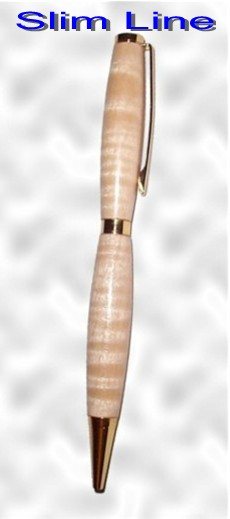

Congrats Daniel, I hope you know you have your work cut out for you. There is a lot involved in taking a good pen picture. Then there is photo editing too. I wonder if you ever did any stuff like this.
<b>Image Insert:</b><br />
<br /> 18.68&nbsp;KB
It was taken against a plain white background, and then later auto cropped out, and replaced with a fill background.

Okay, so this is what I have to achieve, drop in background photos. Great pictures and very nice pens to boot. Oh, well, I really didnt have anything else better to do. [:D] Great looking pens Tim !

Ok, I set up my first photo tent. I used "3" 500 watt halogen lamps, some wood for a frame, and an old white bed sheet for the cover. The results were not great. I did eliminate most of the shadows, but the pictures came out very yellow. They were so bad, I could not correct them with my software. I am very disappointed.
My camera's built in flash will not work when exposed to the brightness of these lights. I am thinking that it would be easier overall to use some sort of filter material over the grills on my lights, and forget about the tent. Any suggestions about what material might work for a filter????

Originally posted by Daniel
<br />Tim,
Did you set the white balance on your camera for Incondescent Light?
Daniel,
I have a Kodak DC215. I do not have an incandecent setting that I am aware of. There is an exposure compensation setting that can be adjusted when it is hooked up to the PC. In this mode there are also flash options, auto, fill, or off. Any help will be appreciated.
I do not want to buy another camera. I want good pix from this one. [:)]
