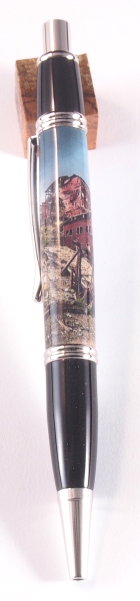

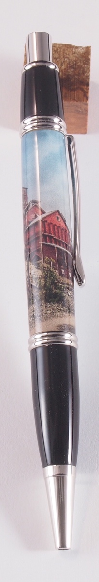

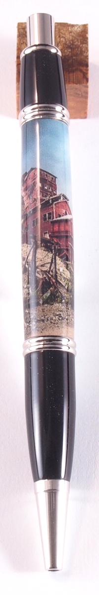

A friend and coworker recently returned from a trip to Alaska. Her husband is a very talented photographer. She asked me to do some label castings of photos of the Kennecott concentration mill. Here is the first of two pens that she commissioned me to make. I am very pleased with the clarity of the castings.

Fantastic Pen, Cody.
Great Photographs, Excellent Blank.
Your Usual, Perfect Fit and Finish, is ever Present.
Great Craftsmanship.
Congratulations,
Brian.
