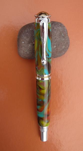

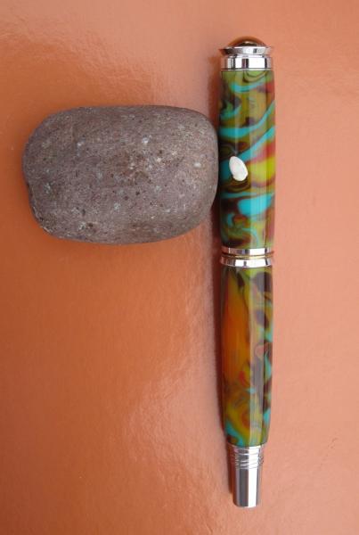

This is a repeat of a post from a few months ago. I thought it would be a good idea to repeat it but with photos this time.
I know many of you have a hard time keeping your pens steady when photographing them. In order to prevent this, I use Museum Putty. This is available from Amazon.com: Quakehold! 88111 Museum Putty Neutral: Home Improvement.
Place a small amount on the back of the pen and it stick to just about anything and can be removed without any harm to the pen.
The pen is a Jr. Retro using a KnB Navaho blank.

There is a MacTac putty that is available in stores such as Staples, Business Office Depot etc. 2 colours blue or white.
When you use it, be certain it is well hidden under the pen. My camera has caught it peeking out under the pen where I can't see it at times because I'm standing up.
azamiryou
Aug 14, 2010
1,015
Silver Spring, MD USA
+1 on double-checking that it isn't showing. I use blue tack, and it's made appearances in several photos that would have otherwise been "keepers".
