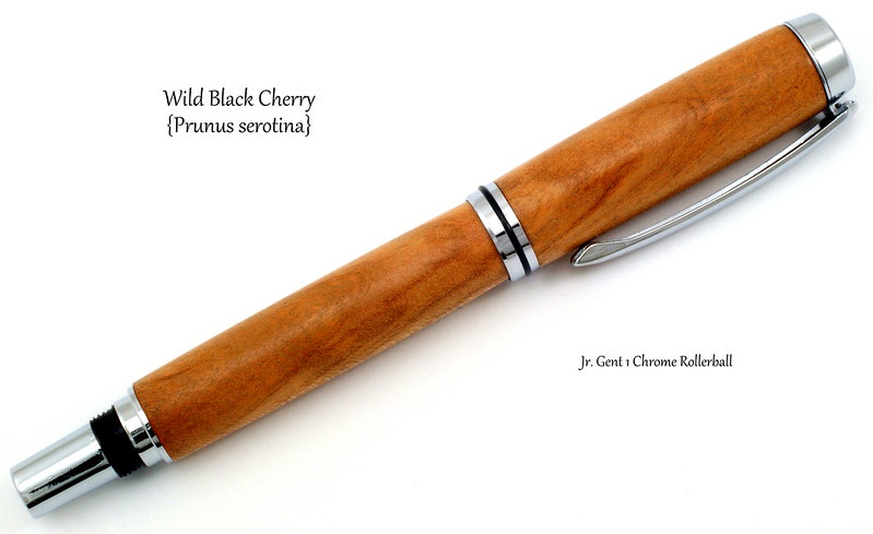

Took a 'time-out' from turning PR swirlies, had the idea I would make a couple of pens. Well, good things happen, and I made three today. All Arkansas Wild Black Cherry, two in rollerball and one in a fountain.
No CA finish was applied to any of these! That's right, I'm on a roll of not using this stuff that melts my eyes and makes my nasal cavity drizzle....and I couldn't be happier. These were all turned between centers, sanded to 1000grit, EEE and buffed with some wax.

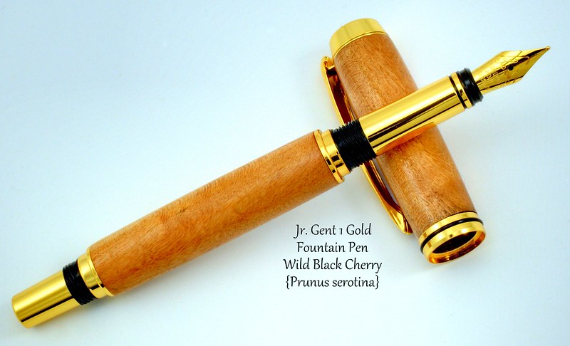

Let's start with the fountain:

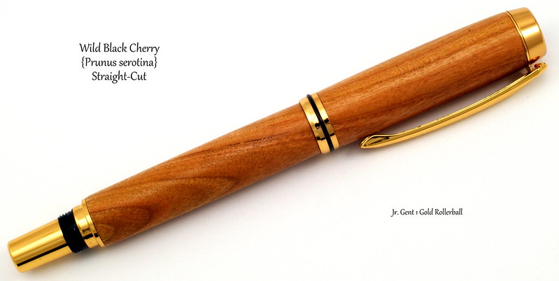

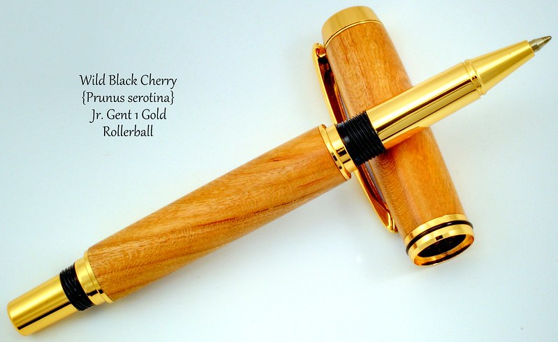

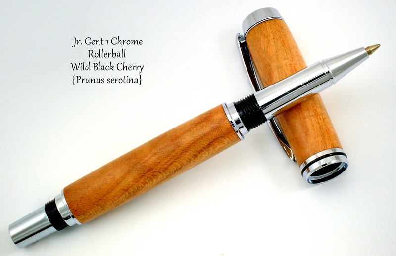

And now the rollerballs:

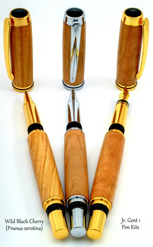

And finally, let's go for the 'group shot'!!!
Had some fun, made some more nice writting instruments, and I wasn't near the 'one-that-has-the-nasty-cold-and-is-grumpy'. Thanks for looking, feel free to let me know what you think. By the way, these three pens....total of $13.83 cost! What do you think the profit on that will be?
