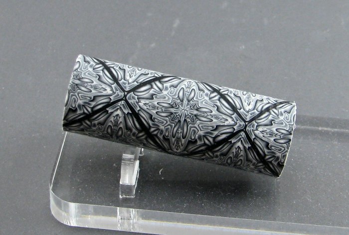

Guess this is the right place to put this. Things seem to be going well, so I'll start showing a little of what I've been doing lately. This is one of Toni's kaleidoscope canes. (She's rather good, isn't she?)
I've come to a stop for now. Below are a few pics showing a bit of how I got to this point. Pretty basic really. This is the top barrel of a Statesman (BTi). It's not down to size yet.
There's a lot I will do better on the lower barrel and even more the next pen like this one I do. A good start though.
Tiling the cane
Completed sheet
On the lathe
I did a little test to see how thin CA would affect it. Looks like a CA finish will work just fine when the time comes.

Very nice Eric, A thin ca finish has been working well for me.
I've got it down to size now. I sanded with MM and just finished hitting it with Novus 3. It's got a pretty good shine line already. I'm wondering if I really need to mess with the CA. I will though.
I was off at first with the joining of the pattern at the back, but now that I'm down into the stock, close to final diameter, it has cleaned up nicely. I - almost- couldn't spot it. Almost.
The pattern is showing a little more too. The CA ought to make it even better. I'm seeing a few hairline cracks now that I'm close to the tube. I won't turn it down any further and it definitely needs the CA to bind it all up.
I think it's ready to finish, but I've got places to be just now. More later.

How durable is the PC? I do a test toss of my PR(S41) casts every few patches, and may chip a corner, but no breakers ... So I just am curious, about heaven forbid, a dropped PC pen...
It's hard to describe the texture of this stuff once it's cured. Kind of like hard gritty rubber. If you don't work it up correctly, it could crumble on you. It turned easily on the lathe.
I was worried that it might not adhere to the tube sufficiently to take turning and sanding. I was worried about nothing there.
I can't imagine it breaking, because it is a medium hard plastic and bounces back from a ding no problem. Very forgiving, not brittle at all.
... This one is just too wild!!:eek: I love it. I'd be amazed if the join on the back looks as good.:confused: I hope so!!:biggrin:
It's not as perfect as I was hoping, but it's not a disaster either. In this case, the material selected the pen kit. I was originally going to put this on one of Gary Pye's Super Sedonas, but the cane "tiles" were too big. I discovered the upper barrel of a Statesman was perfect. Now I'll have to use a base layer of clay to bring the lower barrel close to the diameter of the upper, put the tile sheet on and leave it fat. I'll bevel the end to the kit part, but this will be one very big pen.
Mainly, it's to show what the possibilities are with a kaleidoscope cane. A big pen is a good idea in this case.

I haven't tried any cane but now am planning to after seeing this design so I have a question. If this is pliable, how do you cut it without disfiguring the cane itself?
Kaspar
Aug 1, 2006
1,363
Ahead of the curve. Waaay ahead.
Very slowly and carefully. With a very sharp, clay cutting type blade ($4 at Hobby Lobby.) You can cool the cane in the fridge or even the freezer to make it a little more rigid. You will still have some deformation. You can work it back into shape once you've cut the tile loose.
You will notice that the cane itself is not perfectly symmetrical. This pen will not be a perfect trellis of patterns. More like quilt.
