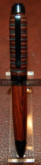

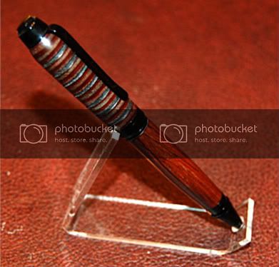

Black chrome cigar. Top is leather turned to simulate a K-Bar USMC fighting knife. Bottom Honduran Rosewood.

Hmmmm. How'd you color the leather, or was it already dyed? I like the looks. Would like to have seen a profile picture.

I turned the leather to finished size and colored it with a brown Sharpie. The grooves were colored with a Black Sharpie. I evened the color out with mineral spirits. All were coated with many coats of thin CA.
This is the one of the best photos I have. I am not much of a photographer.

I am no expert by any means. I do suggest that if you use CA to bond the leather that you have a can of Acetone close at hand. I glued my fingers together a couple of times making that blank.
