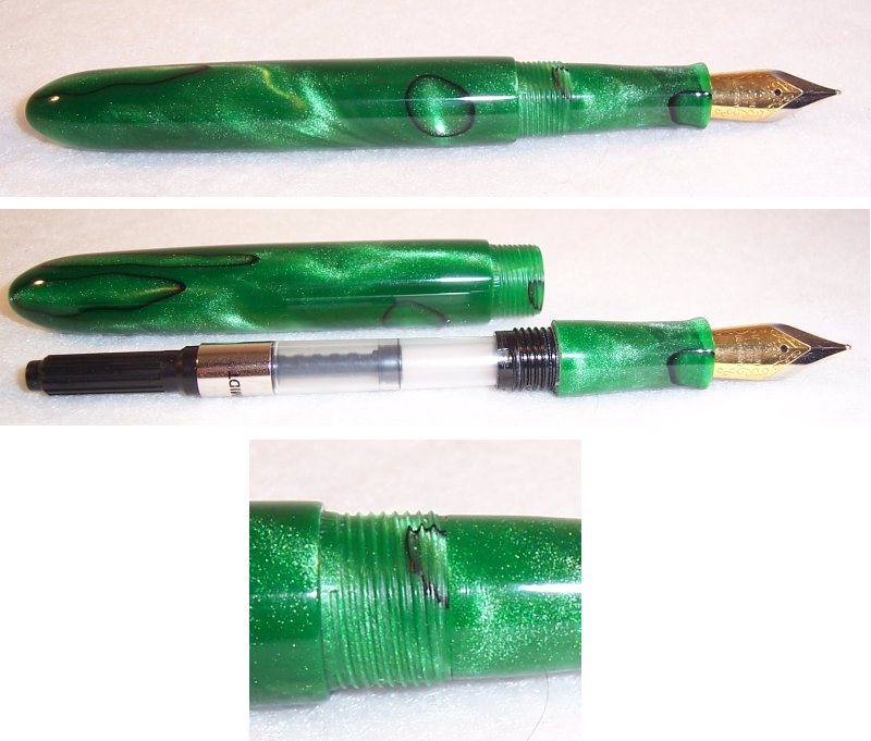

I’m just trying to iron out some wrinkles on a new pen idea. I thought I would make the nib holder from the same acrylic as the body so when assembled I would have a nice continuous flowing body.
Now that it's done and I sit back looking at it, and something just isn’t grabbing me. Have I become so accustomed to the metal accent parts in the kits that the pen just looks too plain?
What say you, is it just too plain, is the shape off or does it indeed need some shiny metal?

My 2 cents: It's too much of a good thing. You need something to break up the shape just a bit. Even the non kit pens (Libelle, Conklin, etc...) use something to enhance the nice look of the plastic.
Really nice job on making the threads and, well everything really!

I think it looks fantastic. But, if you like shiny things, maybe on the cap you could put a small ring of silver or black titanium for the center band.

I think it looks great George. The shape of the pen will change as you make more of these and you will soon settle in on a couple of shapes that you like. Maybe doing some prototypes for shape from inexpensive wood would help you decide which way you want these pens to head. My tap and die are still in the box[V]. You're off to a great start.

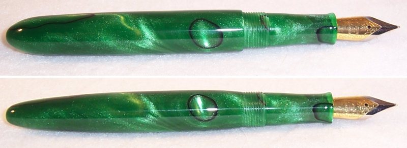

It finally hit me..... off to the shop for some modification!
I think it was the blunt shape, both right behind the threads and the tip that I didn't care for. A little reshaping on the lathe and I think the body flows more into the nib holder.

George I agree it looks great and when you take that course in jewerly making the clip will be all you need, now anyone want to half's on a T&D in Oklahoma?

Dang it, George. You're pushing me to order that T&D set. I don't think it needs anything at all. Looks great just like it is![^]

This is one of those times when I have to swim against the tide. I think it IS too plain. I believe that findings can be effectively used to compliment and enhance the shape and appearance. I'm not oone for the gaudiness of an Emperor or Lotus, but I'm not fond of the opposite extreme, either. Please know that I applaud the craftsmanship, I'm just not crazy for the blandness.

I think it's a beautiful pen! I tend to like the barrels where it's not just straight. Either a little hill at the nib end going into your end, or a hill with a valley into another half hill at the end. I don't know if I explained that right, but I think you know.[?]

I think it looks pretty good -- great workmanship and I like the matching nib holder. I think I'd like to see some contrast in the threads that accept the cap, however. That would break up the lower barrel a bit.

I think it still needs a black titanium washer seperating the two sections. You need something to break it up, but remain fairly understated.
To me one problem is the blank. The black circle in the threads seems like it SHOULD continue onto the nib holder. It doesn't and that stands outs. With a trim ring, it would provide the separation so that it doesn't stand out.

George, very nice work! My personal preference would be to have something else to break it up a little, but I bet there would be people that would love it just the way it is. It definately makes me closer to ordering a T&D set. Thanks for sharing.

looks great, blanks not for me though. i would love it in black, boring i know. prefer how you have thinned the end but preferred the thicker thread end.

I think that you have produced a beautifully styled and crafted pen!:):)[^]
My first thoughts on seeing the pic. were that it grabbed your attention but needed a little relief from the slightly overpowering effect of the green. That overpowering may be attributable soley to the colour, but I don't think so.
Perhaps breaking up the mass of colour with something simple will add a touch of spice. A black thread, a black band strategically placed between the nib and the thread or even above the thread.

Not my choice in colors but I like the shape and simplicity. Overall an excellent job, now lets see what you do with the cap.
Well, the caps are going to have to wait because I'm looking into ways of fabricating some centerbands! I just brought home a piece of sterling sheet and am going to try my hand at making a few clips.
Thanks for all the comments, looks like a broad range of likes and dislikes. Maybe that's why we make so many types and sizes of pens.

What if you were to use some of that M3 makome to make centerbands. Stuff sure is expensive, but you would be able to maximize the product with this use. I have never made a clip, but I find the clip on my knife to be quite interesting. It is sort of Z bent and held on with allen screws. Perhaps not suited for this pen, but an idea useful for some sort of pen, like perhaps a 6 or 8 sided pen. Maybe that's more of a Skiprat style to match, I don't know. I do like this pen. Perhaps some makome as a centerband on the cap portion would add that flare you are looking for. Personally, I think this pen style you are running is pretty ballsy. I'd be scared to death trying to pull that out of my hat without it exploding in my face.

I like what you've done and the work is first rate, but there's something about the shape that just doesn't do it for me but I can't figure out exactly what it is. But, regardless of the material, it is too bland looking. Like Lou, I think it needs some "jewelry" to spice it up a bit.
As far as the sterling sheet is concerned, I hope you're not expecting a truly functional clip. I used to do some silver work many years ago and I think you're going to find that sterling is was to soft. Nickel silver or German silver would work a lot better and tarnish just about as fast as sterling.

Awesome work,to say the least.
I like your concept and execution.
I would agree it could do with a small slice of hardware.
The mods you did look good on the tail,to me.
I rather preferred the more pronounced shoulder behind
the threads before,though.

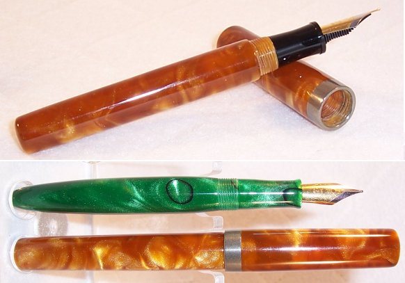

The more I looked at the green pen, even after reshaping it, it still didn’t do it so I made another, and this time included a center band on the cap. This shape I really like and think the homemade center band works well with it. Anyone care to venture a guess as to what the center band is made from?
I’ve received a few interesting emails, please realize that these are NOT intended to be REAL pens, but prototypes or works in progress. Tomorrow I'm going to try a few clips for these.
Thanks for the good discussions and ideas.

Geroge. My complimmetns to your work. I like the amber one better. Perhaps the color itself does it, but the shape it's also more apealing to me.

George - The amber pen is a wonderful design and goes well with the center band. Makes me want to retire so I can try to keep up. I wouldn't be surprised if one day we see your pens in Pen World.

Very nice George. I do like the revised edition, but how does it look with the cap screwed on? What about a couple or three shallow grooves on the nib holder filled with , say, Inlace in a contrasting color? It is a very good looking pen the way it is.

George, I do like the adjustmets you made to the green piece. I'm interested to see how you do in making your own clips and hardware.
