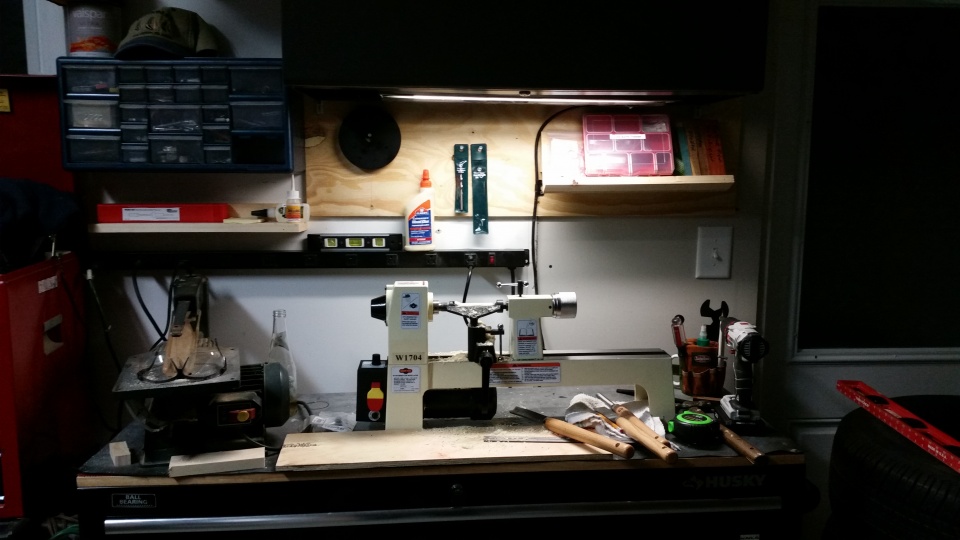

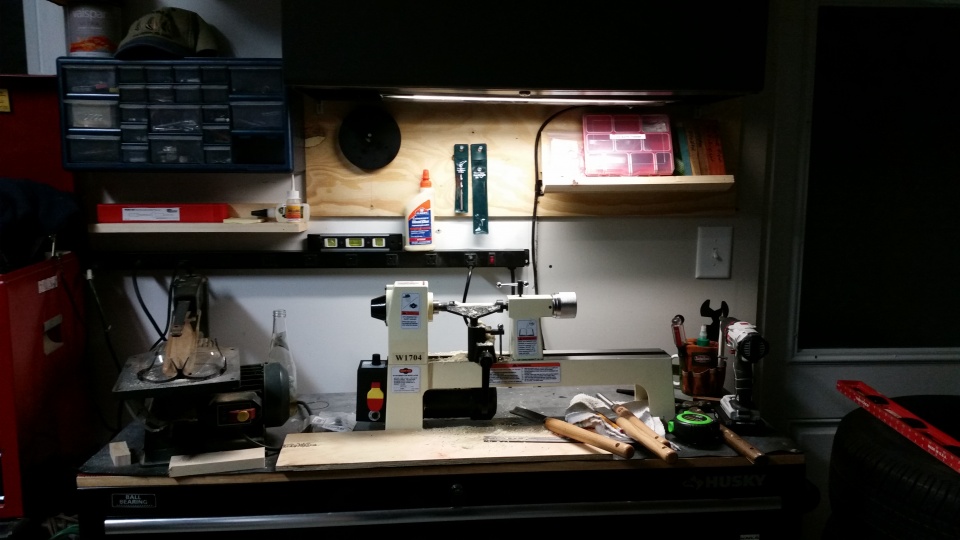

Ok well I have my lathe hooked up. Shop Fox mini.

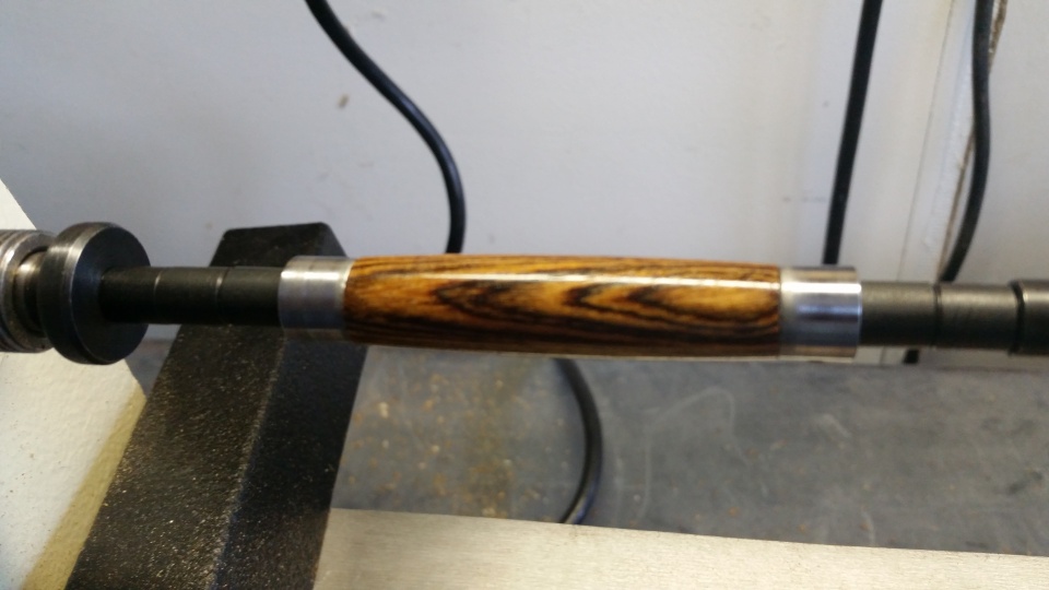

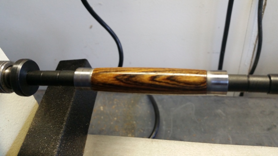

Ray1955
Dec 25, 2016
33
Myrtle Beach Sc
Thanks for your response
I am planning on learning to sharpen my tools.....they are harbor freight.

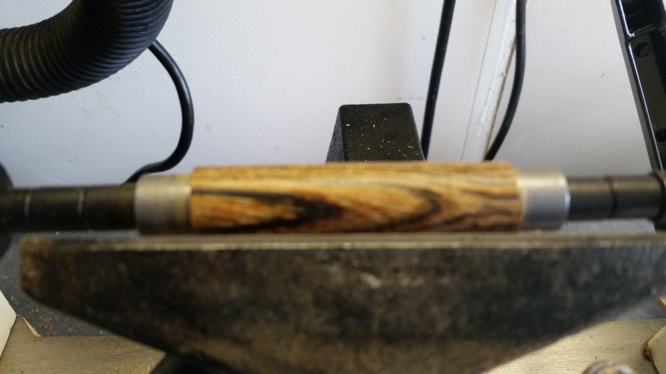

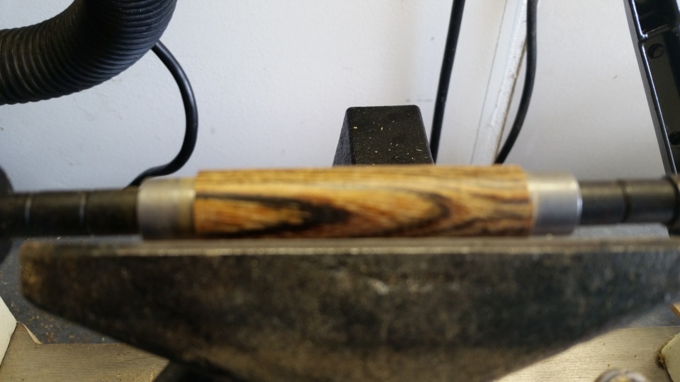

First thing that happened was my tail stock I couldn't get tight enough...I was able to knock off the corners but after rereading my lame manual it did say I may need to reset the tail stock which I did and now it is tighter....good.
Next I noticed the little hang over on the ends was chipping off yikes turn it off and walk back to it and start again going ever so slow on turning.....now we are good I think I need to start sanding.....I don't have the paper I see displayed any thoughts if I were to need say 3 grits which ones I should start with that can be bought at say LOWES?....later would like to get the box that has like 7 different grits.
