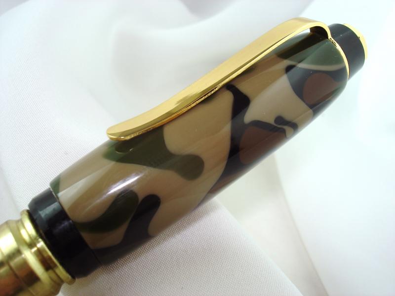

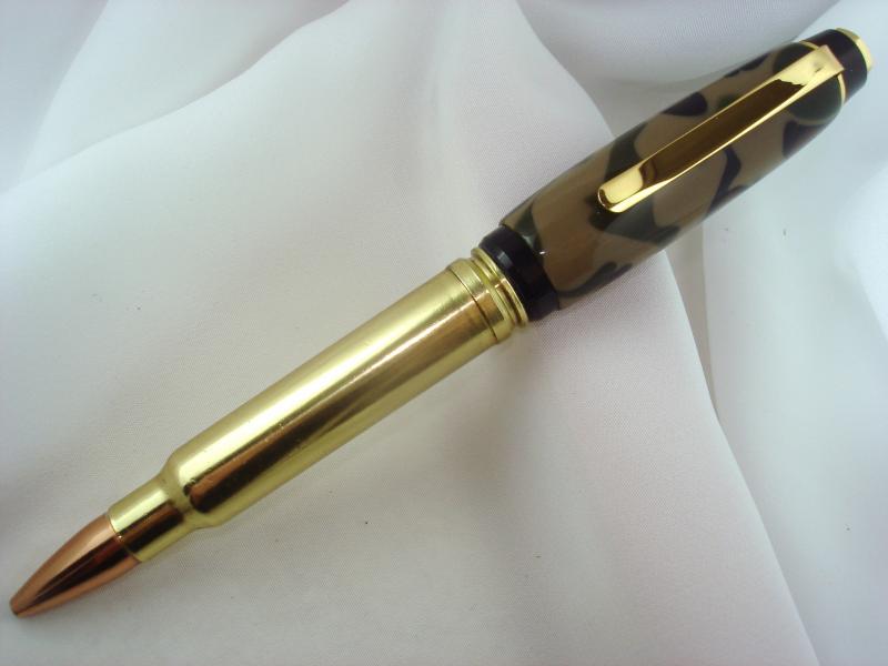

With a Titanium Gold RT Euro 8mm Premium Double Twist.
Shortened the tenon to expose the brass twist holder flange.
Sanded with 400 grit and buffed with super fine steel wool
while still on the lathe and polished with Hut Ultra Gloss.
As always comments and or suggestions appreciated.
Thanks for looking.

Great photography... care to share your setup? What are you doing software wise?
Oh, and great looking pen! I like that kit...

Great job on the pen, and congrats on the front page, you must be doing something right.(lol) Not that you pen needed it, but someone told me about using "BRASSO" polish after sanding to 400 with any kind of acrylics, or man made blanks.
I use it on Corian, and you couldn't ask for a nicer finish, followed by a coat of "ONE STEP".
Again, beautiful job.
Thanks for giving us a glimps.
Tom/oops99

Great looking pen Les! I turned one of those blanks on a cigar and it was ok. After seeing yours, I know what I'll do with the rest of them. Great photos too! This one definately earned the home page. Congrats!
