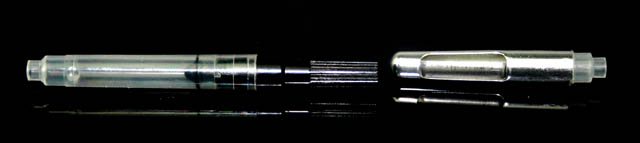

Squeeze type converters eliminate the problem of "to spring or not to spring." I noticed that my Namikis are have them, so I now use them in all of my pens. It is not possible for the spring to activate the pump mechanism. They are a touch nicer than piston pumps and come in two sizes, long and short. As Gerry said, the short pumps fit even the shortest of kits or modified versions of traditional length kits. This picture shows the size comparison between the short converter and the standard piston-converter.
The long converter fits all other kits or custom pens. It is the international standard. You can get them from me for $3.50 each or (mix and match) 10 for $25.00. It's another nice step away from "kit" parts and truly dresses up a pen.
