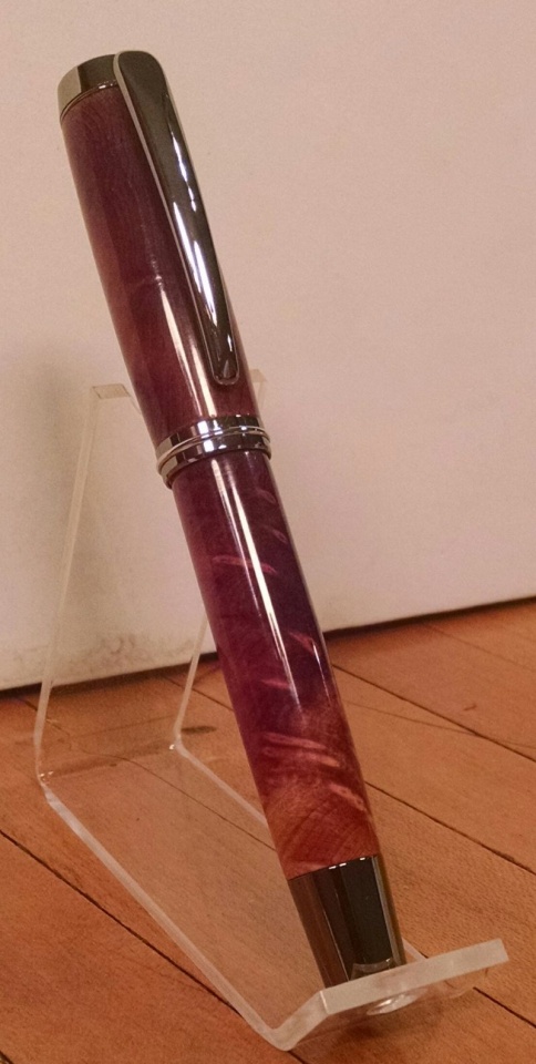

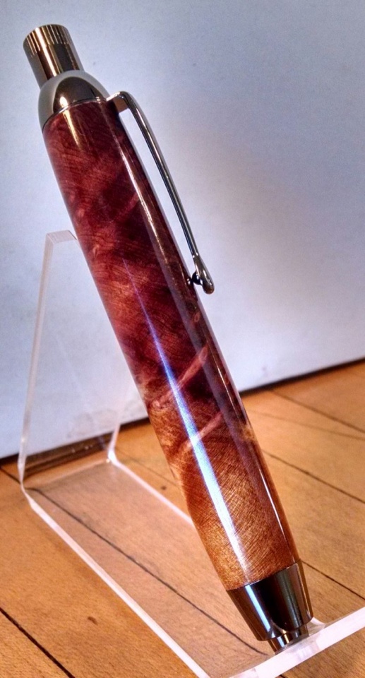

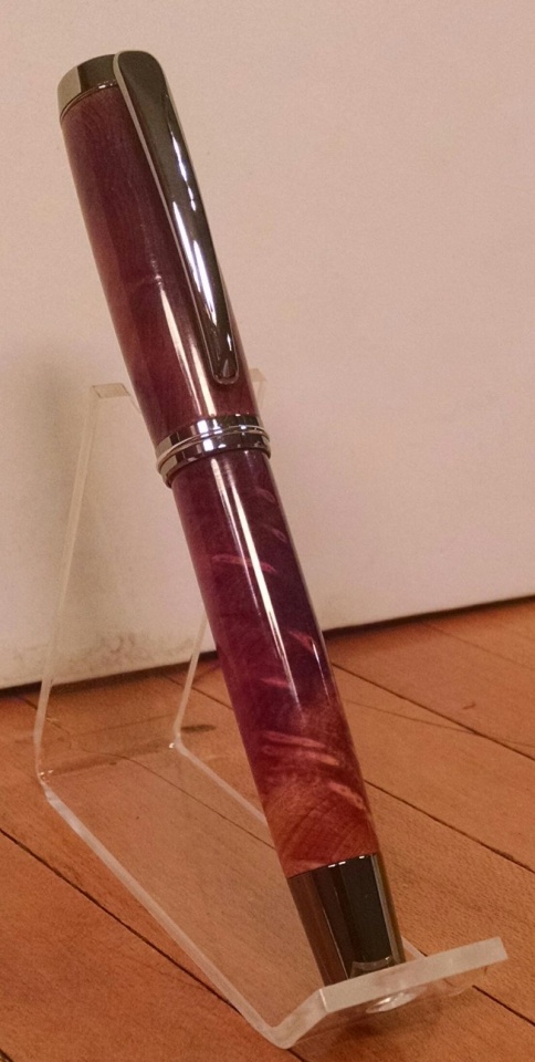

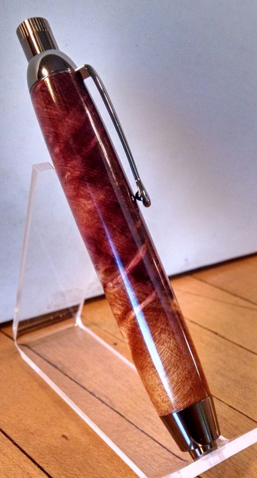

Well, here's a pen and pencil that I am very happy with. It's from a slice of California Redwood that My uncle gave me. The pen and pencil were a gift to thank him for the wood.

Thank you. I'm addicted to this wood now! it's beautiful and I am anxious to do some more, but I don't want to use it on lower end kits!

Very nice!!! Would you share your finishing method by chance? just bought 6 redwood burl blanks from rockb who's from the Redding CA area.

I will surely share, but i messed up a few times on this particular pen. You might not want to follow it! I spent hours on this pen.
BTW, I can't stop buying wood from Rocky! I've been resisting buying redwood from him since I have my own, but he has nice stuff for sure. I technically did buy a spindle of it from him for a shaving brush in case I want to make one.
Anyway, the wood was pretty dry so I turned it down close to the bushings and soaked it with CA to stabilize it.
Next I turned it down to a little under the proper measurements and coated it with CA, not using accelerator since i have been having trouble with CA finishes cracking lately.
Sanded the blank with 400 to smooth out, but I must have had a high spot or been out of round because i had two light colored areas, almost pale, after this.
applied CA again in three of four coats of thin since I was still shy of measurement and thought the light spots might go away after coated, but they didn't unfortunately.
Sanded off the CA again and decided to use BLO/CA finish, hoping the BLO would restore the color to pale areas.
It did, so I continued with BLO/CA applications to build back up then sanded and MicroMeshed as normal, followed by a buffing compound I had from working on cars, then a car glaze which I like.
Turned out great and I wouldn't be ashamed at showing it to discerning experts from this site, but I sure made several mistakes!

Thanks for the info on finishing method. I like to use BLO/CA on most of my wood blanks so I'll try that straight away. I sometimes use Meguiars PlastX on acrylics... Never tried it on wood. My daughter is the one who thought up the Redwood trip to N. Cal. Was going to make a couple of pens from Rocky's blanks for her 21st birthday this month. They have some really nice figuring so I hope to get something as nice as yours. Thanks again for sharing.

beautiful pens..i personally love the jn gent pens..iv turned
a few.they have a good weight on them which makes them appealing.

Me too. It was my first one and I really like the looks of it.
I'm doing a Jr. Aaron fountain pen in Irish Bog Oak. I'm almost done, but keep getting sidetracked with stabilizing:)
Most people I know don't have a desk, so most of my friends/customers want a pocket pen. I have a couple future orders, so I'm anxious to play with new kits!
