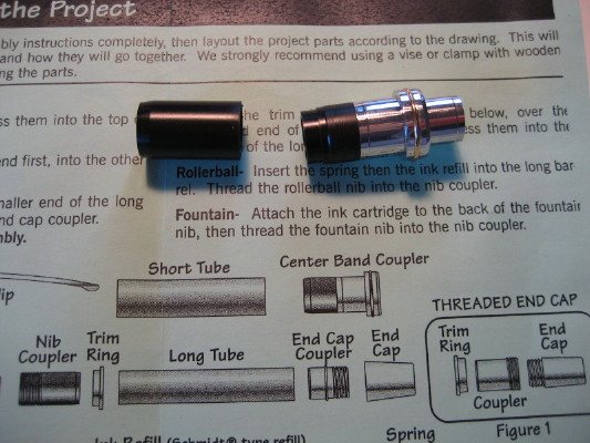

Pic attached. The mystery part is behind the center band coupler.

I didn't get that part in my Jr Gent II, but got it in my Jr Statesman II. It didn't fit into the upper barrel and I couldn't figure out where it went either. So I left it out during assembly. Hope that wasn't a bad choice. [8)]

I just checked my other JG II's. The mystery part is in both rhodium fountain pen kits, but not in the titanium roller ball kits. My guess is that it is intended to be inserted in the upper tube as part of the center band assembly. If so, I don't see what purpose it would serve except to add some weight and maybe balance to the pen.

this was brought up before. it seems that that piece is only to hide the brass tube when you look into the cap.makes it look all black. I have left it out and also installed on some and seeems to have no other function.

That extra plastic piece is to keep the nib aligned when closing the pen to avoid cross threading. It is their latest fix for the thread problems these pens have had.
