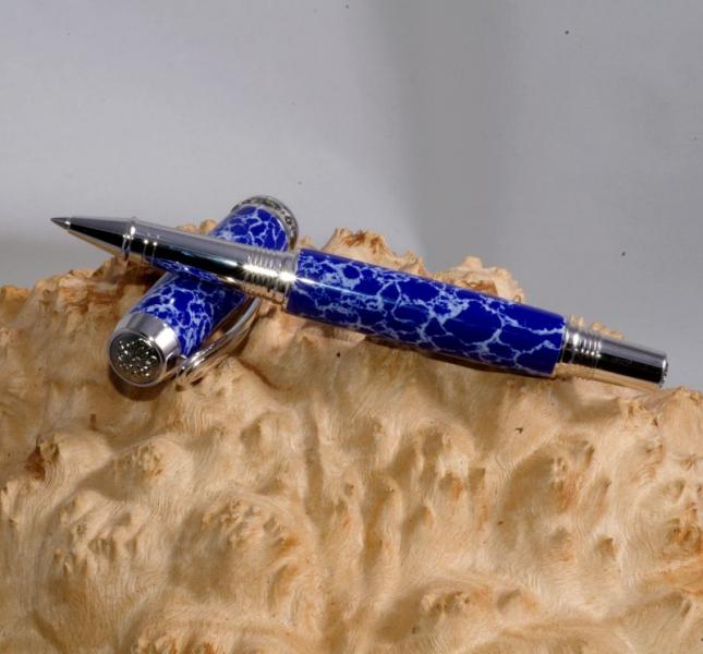

All are similar. You will probably have the same objection as to the amount of metal on the others. Also the jr statesman, gentle man, and the "retro" use the same tubes, in fact they literally use the same exact same bushings craft USA lists them for each pen but if you look at the part # they are the same. below is an image of a statesman jr
