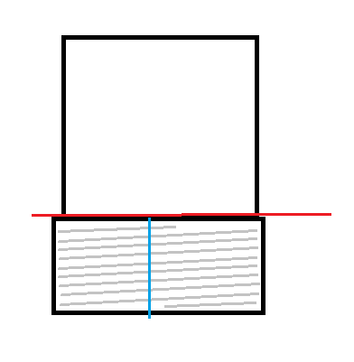

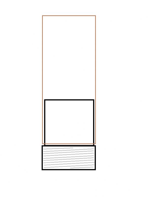

My problem is not with the finial, but the other end of the cap.
I drew a simple example in paint.
The blue line is the crack I got from pressing the piece in, the red line is where it broke off shortly after I noticed the crack and wiggled everything around.
Im assuming the new metal piece is somewhere around the red line that I drew?
edit: the brown is the cap

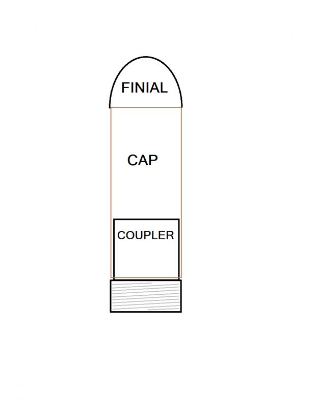

I dont know the exact name, but maybe it is called a centerband coupler. Its the bottom of the cap, which looks like the centerband when the cap is on. I think the kit was a Churchill, which is now called something different from Rockler.

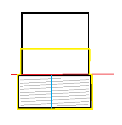

I stopped by Rockler and looked at the Junior Gents (II maybe?), now called something different since they are changing suppliers, today. The part is metal where it matters, so i picked up 2 kits. I edited my little pictures to try to show it. The yellow is metal on the Jr. Gent.
