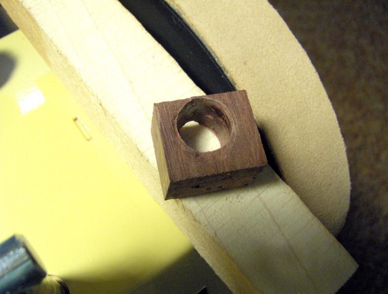

Hi, i had the same problem with the Gent. This is what i do. I made a jig to press the clip onto finial first. then press the assembly into the tube. Notice that the clip side of the wood jig is narrow enough to fit in between the clip and the finial so that it can be pressed on. Look below.. I will have to make another after doing about 12 pens.
