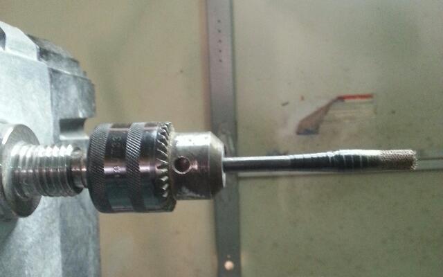

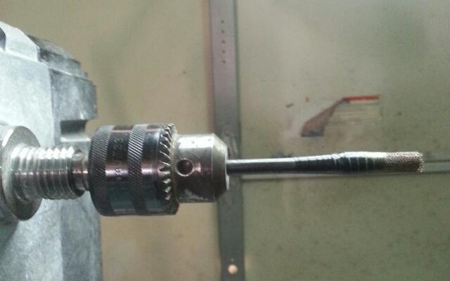

When I use a high-dollar cast blank, I use this to increase the ID of the tube: rps20140313_131020_795.jpg
A piece of 150 Abranet secured to a transfer punch. Take off just enough for a slip fit and add Loctite to secure the parts.
Sometimes the cast tubes are tighter than non-cast tubes. Those can get expensive really quickly.:)
