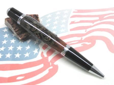

John thanks again for the awesome blank it turned like a dream. Used a Wall Street 2 kit from WC. Wet sanded to MM 12000 then applied ren wax.
The Photo does not do it justice but it`s the best I can do being camara challenged as I am.:biggrin: The colors are great very crisp and clear.
Hope it meets your approval.

Great job. Did you find the WS II a good size for this blank? I used a vista on mine, as I was NERVOUS about taking it down to much.

Mark, Thanks for looking. The size of the Wall Street 2 seem to do fine.
The nib end turned to .517 and the clip end turned to .543. I was a bit on edge but I really don`t think I came that close to the feathers after all is said and done.

Perry, Beautiful job on the pen. Nice shape and shine! Im glad you liked it and thanks again for the pine cones.
