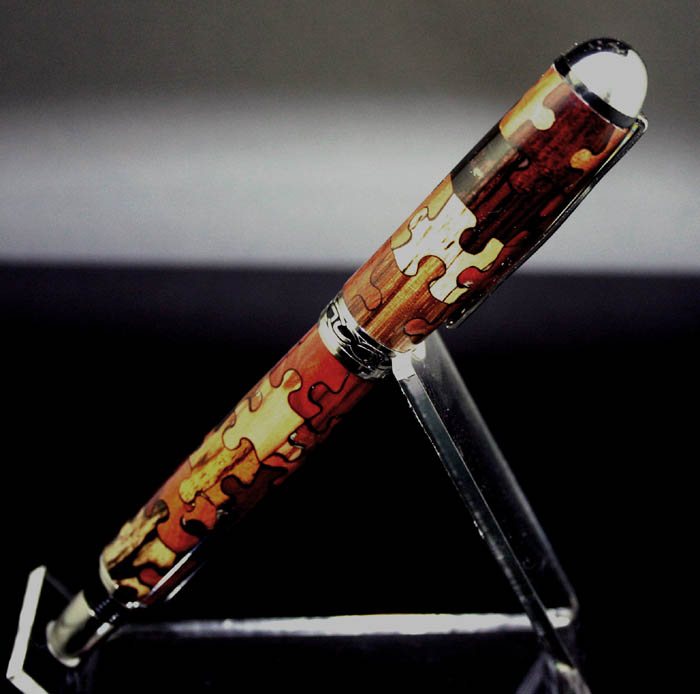

Ken Nelsen and I have been working together on this concept for months. He chose to be the "guinea pig" and submitted his pen to the PMG and was selected for membership. Congratulations, Ken! Here's a link to Ken's version. http://www.kallenshaanwoods.com/servlet/Detail?no=57
Here's my version. BEFORE:
In the end.
View 2
Thank you for looking as especially to those who comment.

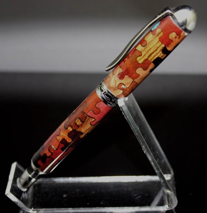

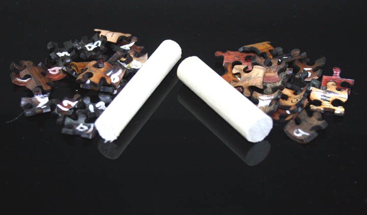

Thanks to all who have posted kind and generous words! This design was a bear for both Ken and me. Ken had to take my 2-D concept and convert it to 3-D plus work out the dimensions and account for bevelling each piece as the OD for each piece is greater than the ID. The assemby process is a bit convoluted, requiring some pieces to be positioned from the outside in and others from the inside out. Assembly required basic setup using scotch tape, followed by tightening and aligning using elastic bands, then followed up with tiny spot attachments with CA. I reamed the inside of this blank, then saturated the inside with CA such that I could leave out the tubes and simply glue in the components.
This pen is VERY makeable if (and that's a big IF) you follow the instructions. 36 individual, non-duplicated shapes, 20 different woods, $55...A BARGAIN!

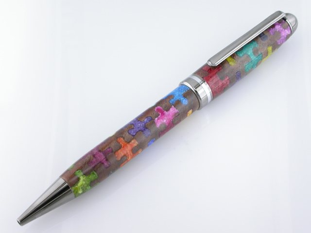

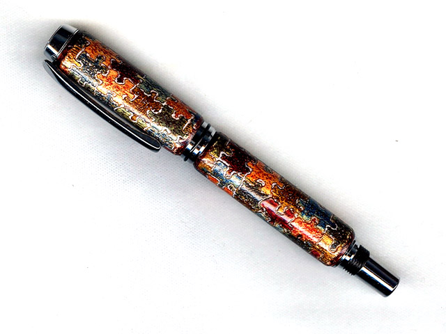

A few 'old-timers' on the site reminded me of how far we've come in puzzle pens. Let's see how many of them you remember.
Ryan Pastorek 9/14/06
Me 7/19/05
Me 6/20/05
Bruce Boone 2/10/05
What a long strange trip it's been!

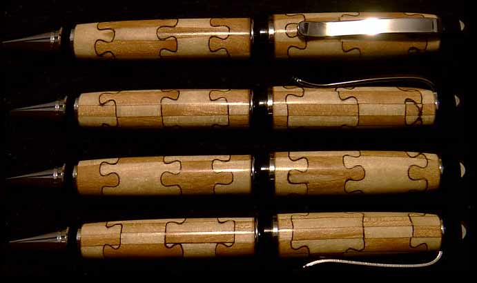

I did my original ones the way you are doing them now. They were very time consuming to put together and never did fit very well because of the small tubes and tight curvature. (I still have never made a kit pen other than the Euro!) My first couple also reflected the laser beam off the brass tube and cut back through the part, so I saw they would need nonreflective mandrels to laser them. Bigger and thinner tubes of a fountain pen would definitely help allow the parts to fit tighter. I stopped developing them when I saw how much time they were going to take to make. I'm glad somebody took the time to do it. It's a nice look.
My original concept was to use a dark and a light wood, so just 2 parts would have to be cut. I scaled the pieces so they could intermix continuously. As you know, it takes a lot of work to get the puzzle pieces to connect properly at the start/ stop line. Once the laser code is done, they are pretty straightforward. I revamped the code to cut out half the pieces and leave the other half standing as one continuous piece. This was an effort to save labor, but it ended up taking at least as long to make. I sold that particular one to a guy at a pen show. It was so much labor that I told him it was a one of a kind!
