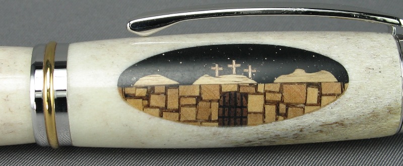

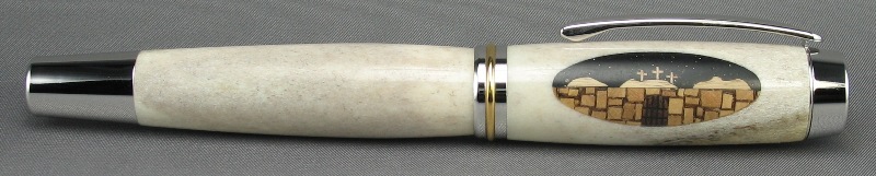

Scene looking out from inside the walls of Jerusalem
whitetail deer antler
Wall- bethlehem olive
Door-walnut, ebony
Mountains-orange
Crosses-dogwood
Thanks for looking!

Thanks for the comments. That was my 2nd go around. The 1st attempt the inlayed did not look right when I turned it. To make the hole for the inlay I made a jig that I use with my router. The rest of it is done shaping the wood pieces on a sander on my lathe and putting them together like a mini puzzle. Then dying some epoxy and pouring it in for the sky background. I do not have a lot of time so the pen took several months working on it a little at a time.
